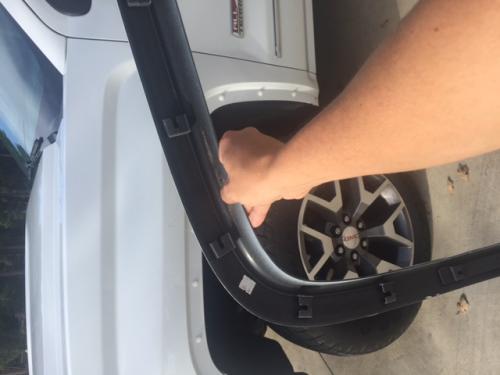

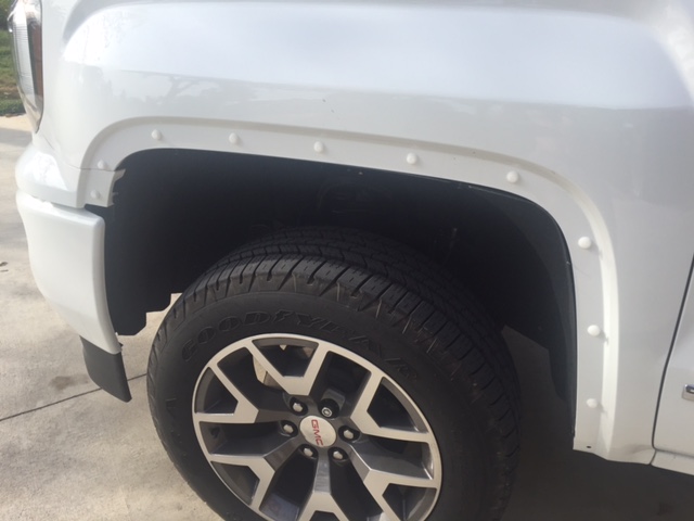

Well I ended up pulling mine off and having a body shop paint them. I couldn't find much info on how exactly they were attached, came off etc so I took a few pics in hopes that it may help someone out in the future. There are also some screws and bolts to remove but they are easy to find.

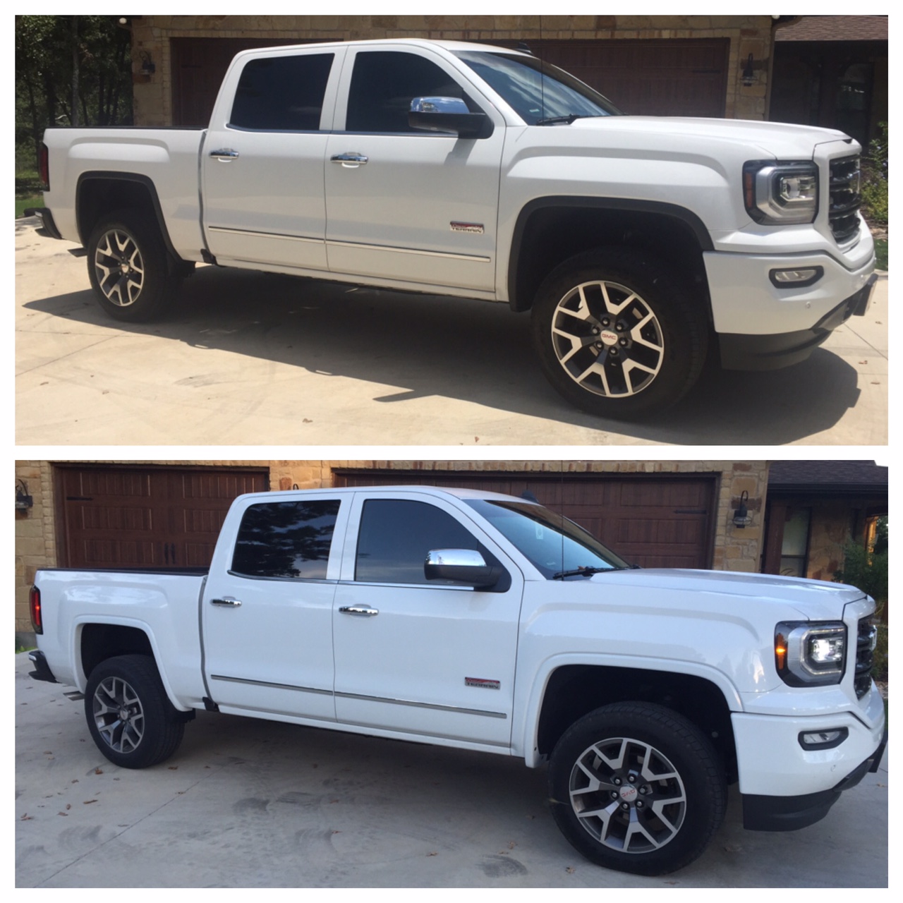

I'm extremely happy with how they turned out! Last one is a before/after with different lighting of course but you get the idea... Also made the GMC emblem on the grille and tailgate white as well, now bigger tires and I will be done for a while...
Looks great Connor! Do you know if the shop did anything specific with the paint or extra clear coats to make them hold up to chipping from rocks and road debris?? My local paint shop told me it would be a waist of his time and my money because they would just look bad after a few months.
Thanks! The guy used some sort of auto paint adhesion promoter. Said he uses this anytime on plastic. He also sanded them some. Gave me a lifetime guarantee that they will not chip off and only charged $250...
Awesome Info and much appreciated!! Now I just need to find a body shop that is familiar with this process.....Thanks again Connor!

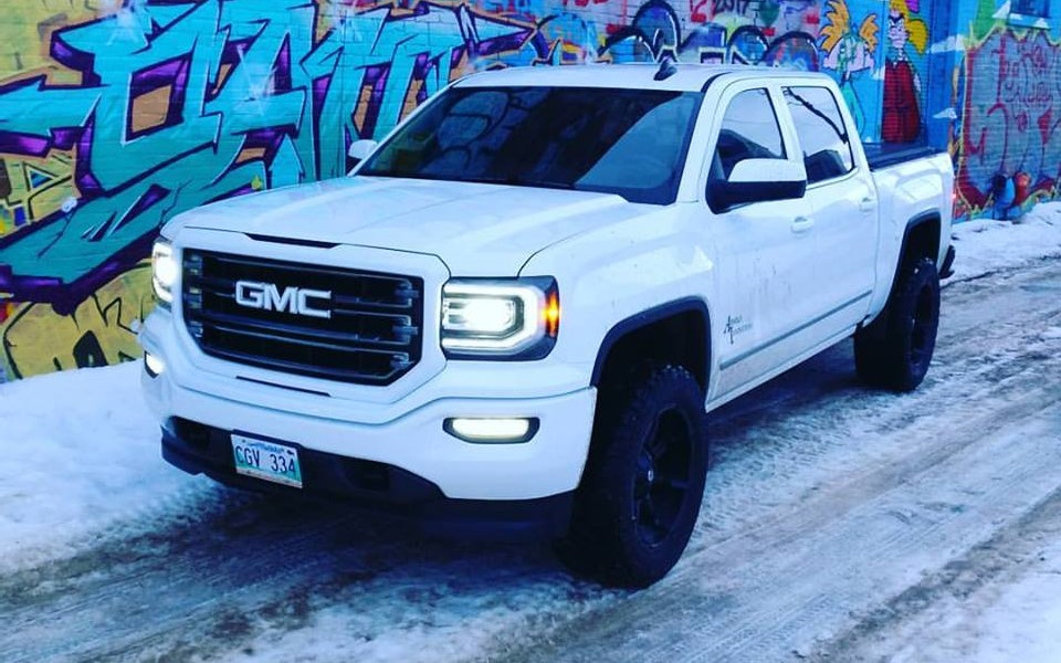

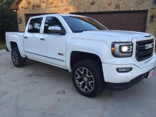

White trucks look so much better with painted arches IMHO. On the other trucks I like the looks either way - they look good painted and black.
Nice looking trucks fellas!

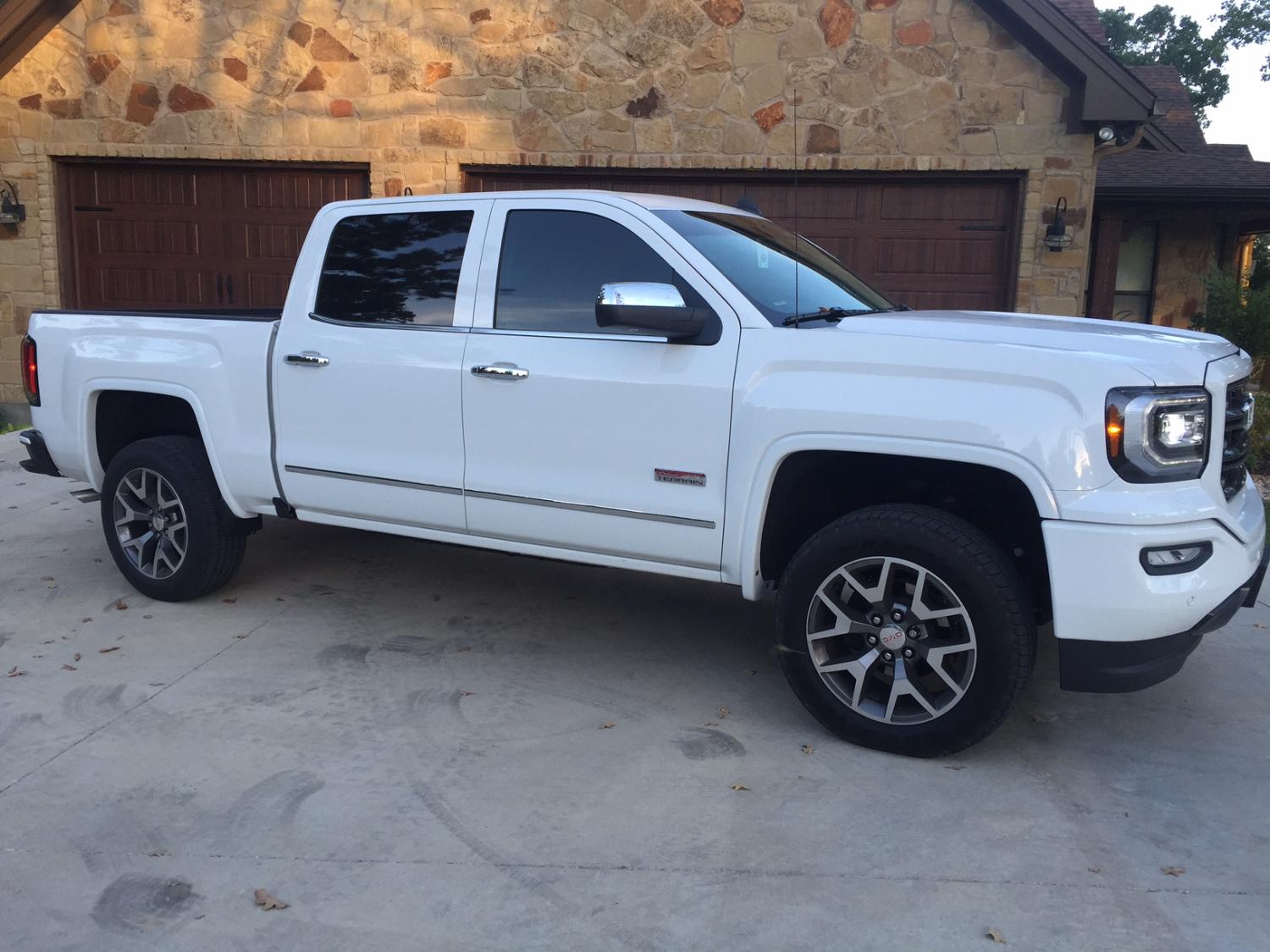

This looks good! thinking about having mine done now... What do you guys think?
  • 1 month later...
Go for it! Just get a competent body shop that knows what they're doing and will apply Bulldog Adhesion Promoter or similar. 97 Indigo Blue Tahoe lasted 9 years with Monochromatic bumpers, grille, mirrors and door handles with just negligible paint chips on front bumper and grille.
