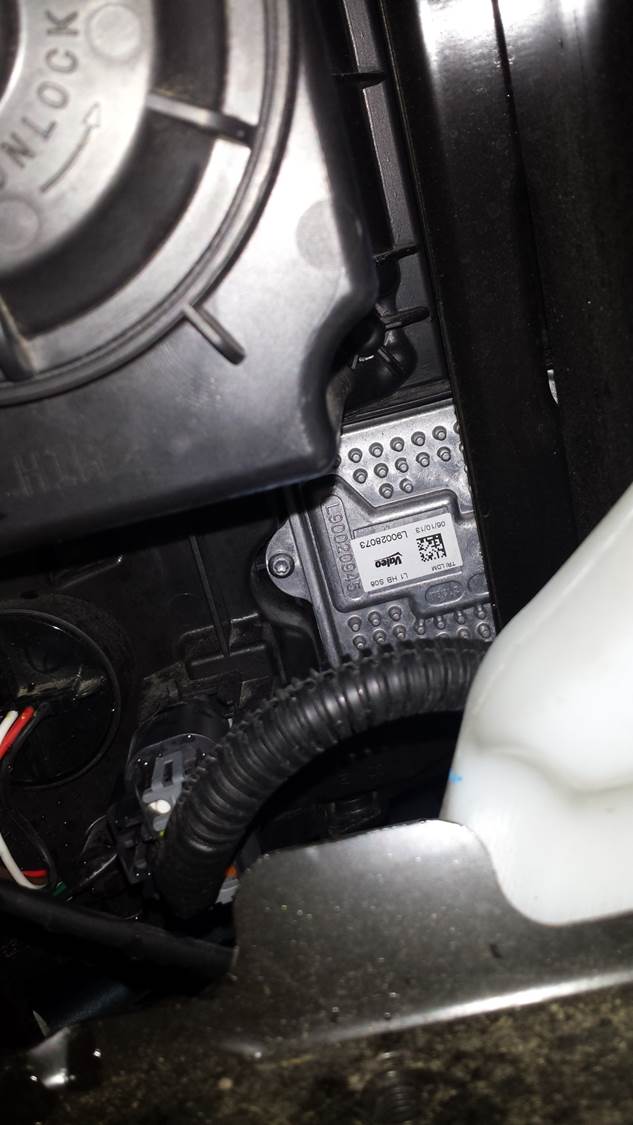

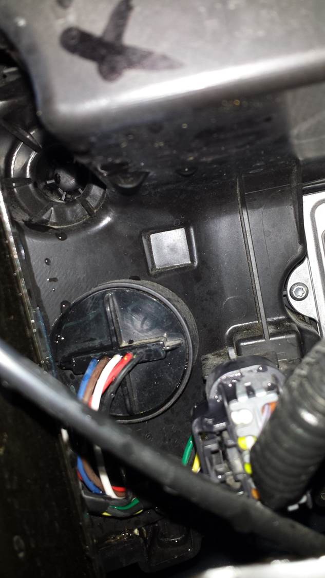

I have a 2014 GMC Sierra All-Terrain with the Bi-Halogen projector headlights. I am looking to open up the case to retrofit the projector with HID and baking seems like the best option.
Did you remove any of the equipment off of your headlight or did you leave it on as block8head suggested? What about removing all the bulbs and the DRL control module on the back of the headlight case? That is the grey metal unit identified by part number L90028073 in the attached pictures.
Did you also leave all the caps securely in place in the headlight unit when baking?
It's not completely clear from the previous post, did you bake it at 220 deg F for 8 mins? Does it need more than 8 mins in the oven to completely open the headlight?
