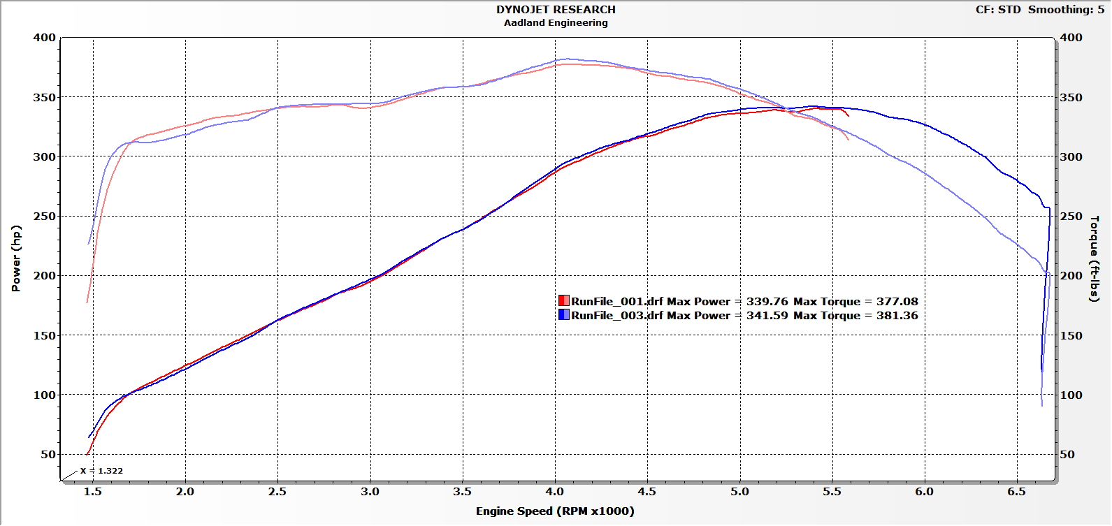

People often post charts with the STD correction factor (it gives higher numbers), so here it is with that in case people want to compare it to such charts:

Way cool! Thx for posting. I'm assuming this was a 3rd gear pull? The torque is nuts down low for being an NA engine. That's why the bitch plants you back when you hit it! :driving:
Yes, 3rd gear pull with converter locked. I know I could have gotten higher numbers in 4th, but I felt I might be pushing my luck with the stock driveshaft at 165 MPH.... And 3rd gear pulls seem pretty standard with 6 speed trucks, so it should be comparable to most dynos you see.
I've been impressed by the tq curves of the 6.2 and 5.3L. They are pretty solid for a N/A engine. That's also a reason why we are getting pretty descent mielage IMHO.
Your dyno's def show why the 6.2L feels so strong from ~3500 on out...it's a steady hold of ~350 lbs ft and around 300+hp.

STD Dyno graphs mean nothing to me unless we are comparing the effects of altitude/temp/humidity but you are correct, a lot of Dyno's (typically flybynight) give STD numbers because they don't have the proper equipment to record SAE or they do it to get kids coming back that use their Dyno sheets as bragging rights. I really was expecting yours to be higher but mybe 3rd and those tires are eating up more than we think, doesn't matter though, like you said, it's for comparison purposes.
