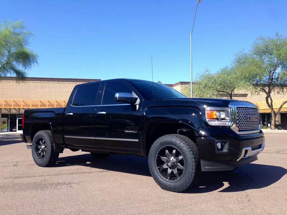

I'd rather not cut, I know the black denali is running the 275/65 without cutting or trimming on a +20 rim.
