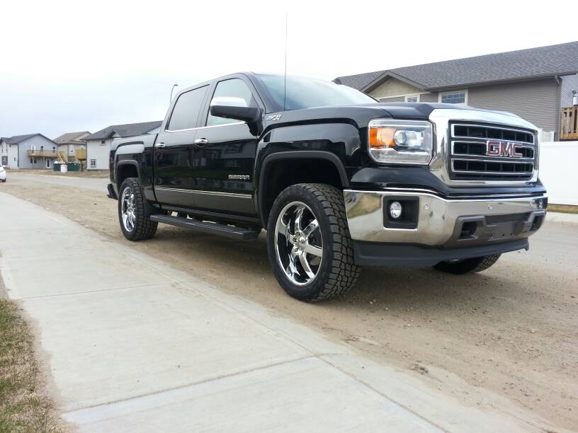

22 x9 Boss 330's 32mm offset
285/65R22's Nitto Terra grapplers, 2.5" level
Very minor fender well rubbing at full lock post-134009-141256199837_thumb.jpg
