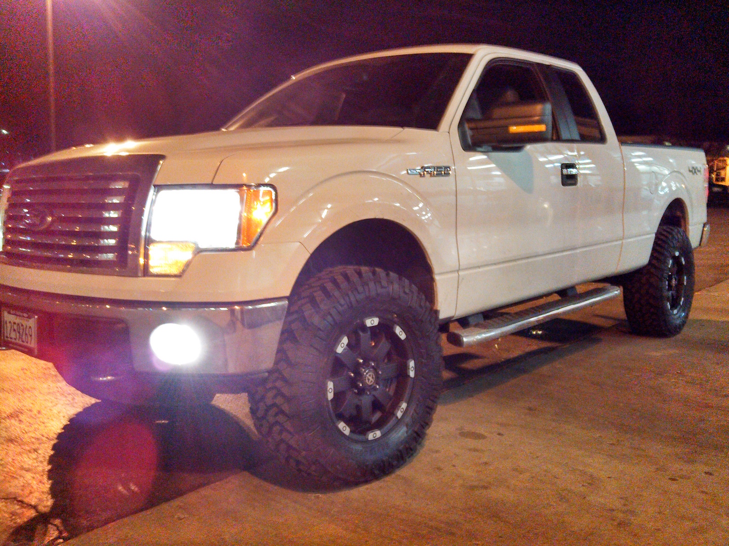

RC 2.5 3" blocks in the rear w Firestone Airbags
18x9 -12 Ballistic Razorbacks Toyo MT 295/70/18
Slight rub at full lock.
Now wanting 4-5 lift and run 35/12.5/18

Looks great. There is still some white showing though... :lol: Good to hear about the 295/70's. one that I am considering.

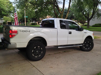

My old 2012 F150 with 35's and a 2 1/2" front level and 3" rear block
