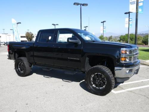

Looks good. You ever consider losing the steps? I think it would look much cleaner.
Thanks! Yeah I've been meaning to take them off, just haven't had the time yet.
