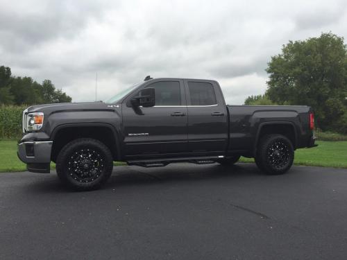

Anyone on a 18x10 with 0 offset?
Sent from my SM-G900W8 using Tapatalk
I got 18x9's in +1 offset.
How's it look got a. Picture
You want to see how far they stick out? Or a side shot?
Both if you got and maybe a tire size
Tire size is 285/65/18. Heres a side shot, I will take another tomorrow to show how far they stick out.
