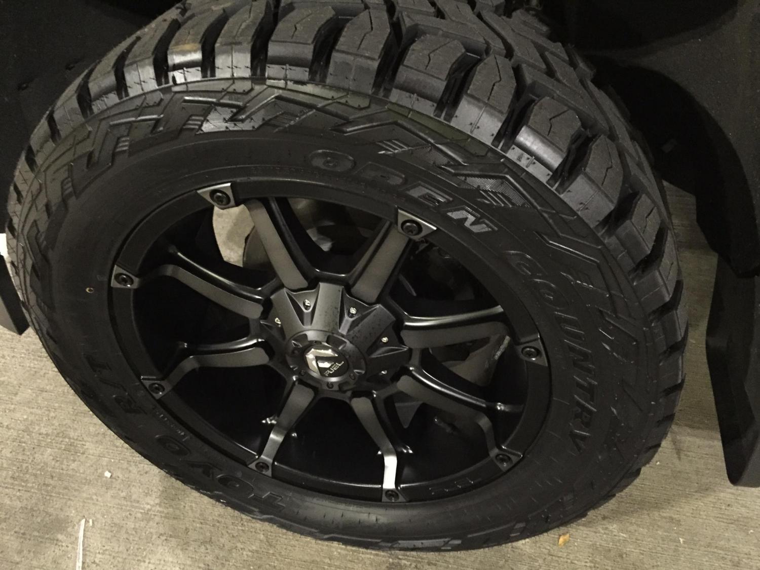

Quick rinse. I'll get better pics sometime. 305/55r20 cooper stt pro on 20x9 fuel nutz pvd +1 offset
Requesting pic down the side :)

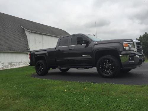

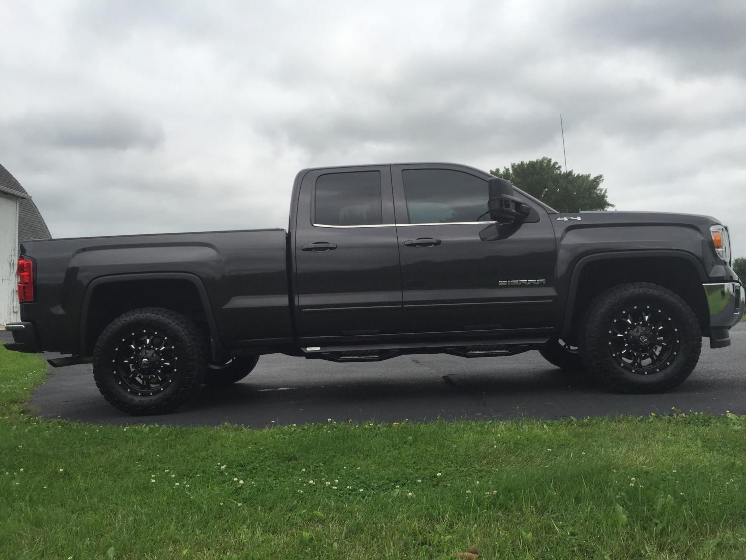

Tire size is 285/65/18. Heres a side shot, I will take another tomorrow to show how far they stick out.
Those 285s look really nice but it looks like there is still plenty of room around them for the next size larger. Is there?
I got about 1/4"-1/2" clearance at full lock, but thats because of the wheel offset which is +1. Higher offset would give you more clearance. I wanted them to stick out abit and didnt want to trim, so that's why I went with that size.

The higher the number the more they will be in the wheel well, you cant go to high or the tire will rub the control arm. The lower the number the more it will be out of the wheel well. Depends on the look your goin for and tire size you want.
