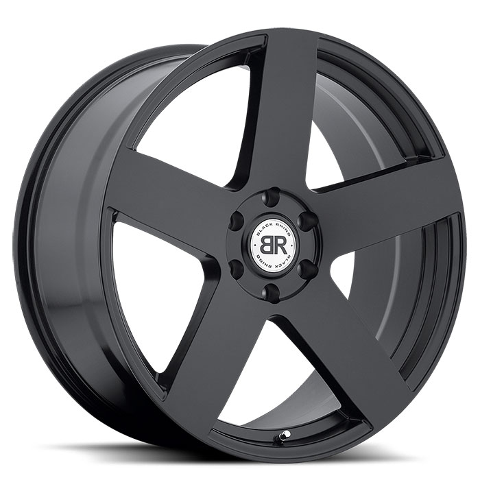

Any thoughts on these wheels?
http://www.blackrhinowheels.com/truck-wheels-rims-Everest.php
https://www.google.com/search?q=black+rhino+everest&source=lnms&tbm=isch&sa=X&ved=0CAkQ_AUoA2oVChMImv6RwNLTxwIVRvI-Ch2xtgi4&biw=1920&bih=1031#imgrc=_
I'm thinking of a set in 20x9 to replace my factory 18's along with some Cooper A/T3's.
attachicon.giftruck-wheels-rims-black-rhino-everest-6-lug-both-matte-black-std-700.jpg
Those looks good, almost same design as the KMC 690. You dont have any chrome on the side, so they fit well.
