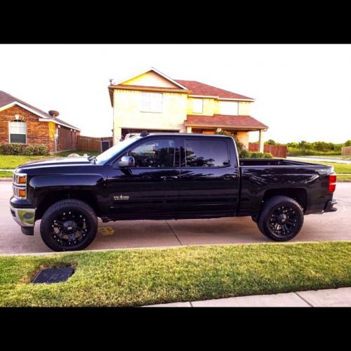

Found a buyer for my stock tires, finally! So I decided to go with BFG KO 2's! 275/70/R18's. The ride is definitely harsher and fuel mileage has suffered slightly...but they look so sweet!!! Plus, they really make the truck look more rugged, like a true 4 by 4IMG_20150810_160804.jpgIMG_20150811_071643.jpg[/urlIMG_20150811_072124.jpg

Very nice. Thanks for posting this! On a side note, one of the my subordinates just came into my office and said "Did you put new wheels and tires on your truck?" I said, just tires. He said "Man, that really changes the look of your truck!". Perfect. :)

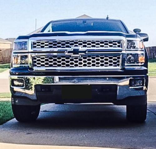

Thanks, but I was looking for "on the truck" measurements as each tire mfg is different. For example, Nittos tend to run wider but not as tall. BFG has always run true to height, but the width is lacking, especially in the tread and section width.
Prdtrgttr and fpdsniper pics show that....BFG is a tall tire, but very narrow looking from the front and rear.
"Z71 Chevy" added the 1.5 BL to the level and has some rub with 295/70r18, so all signs point to 285/65r18 on a leveled truck unless you increase your lift or want to deal with some rubbing.
