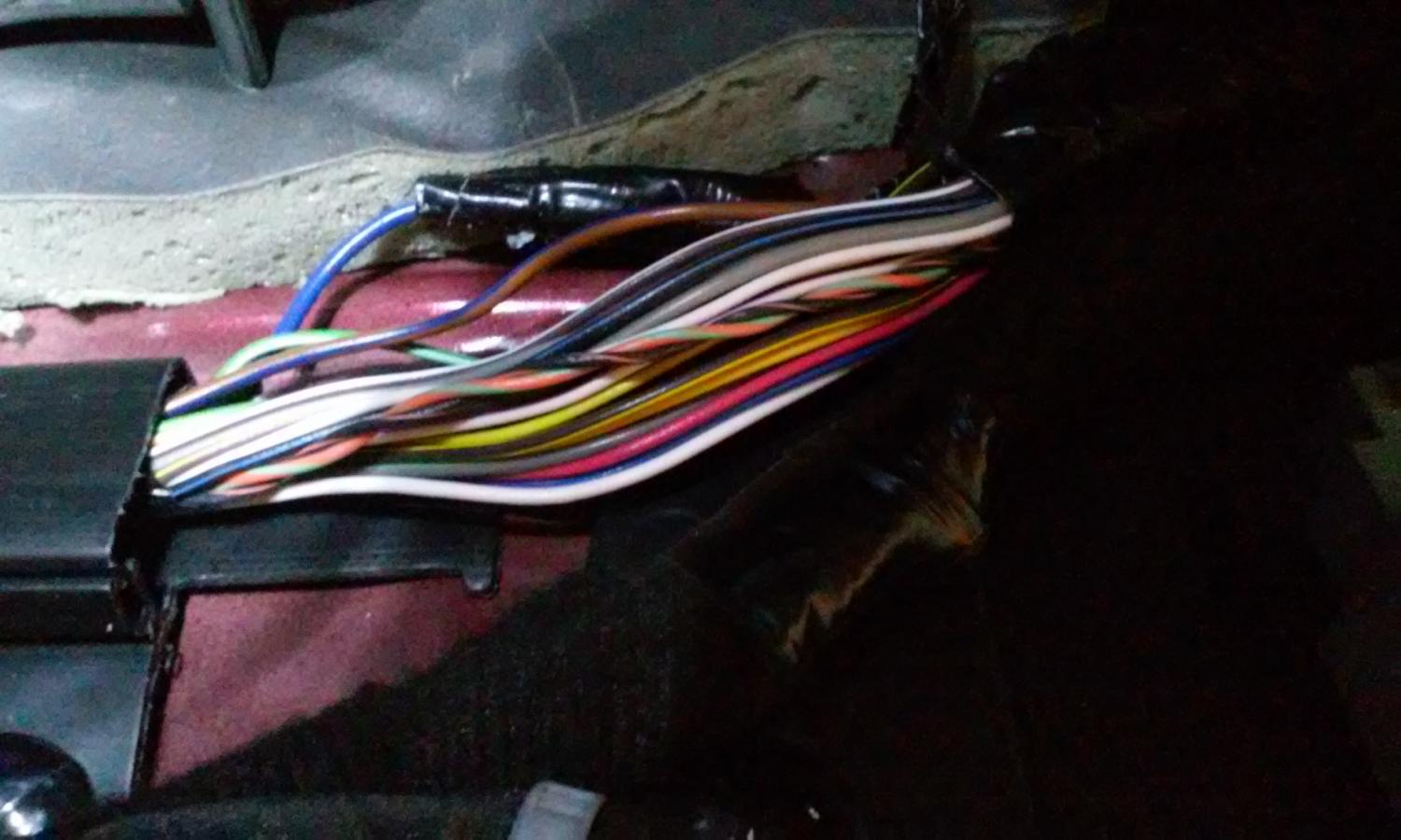

Here are some pics of my install, I have Bose so this is just the SubStage kit (200w amp and sub only) and not the SoundStage...
attachicon.gifimage.jpgattachicon.gifimage.jpgattachicon.gifimage.jpgattachicon.gifimage.jpgattachicon.gifimage.jpgattachicon.gifimage.jpgattachicon.gifimage.jpgattachicon.gifimage.jpgattachicon.gifimage.jpg

As my luck would have it, my 2015 Silverado LTZ w/Bose has a different colored pair of twisted wires than shown on others wire taps. I do have the blue & brown w/blue stripe, but they are not the twisted pair in the kick panel wire plume running up to the door. Mine are black w/red stripe & orange w/green stripe. Kicker recommends that I open the big, main harness & tap into the wires there. Anyone else have suggestions or the same issue I have with the twisted pair being different? Any help/advice will be greatly appreciated! Thanks...Bob
