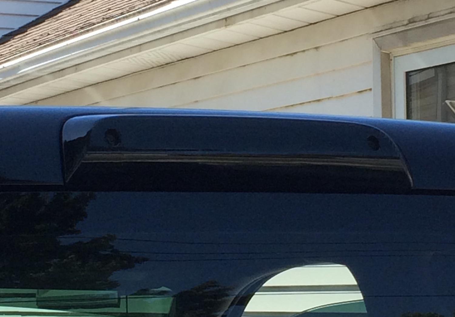

So I went a head and bought the Led 3rd high mounting brake light. The light came today and come to find out that it doesn't fit :(
I'm just gonna stick with the factory and put the led bulb in there... Will contact the seller and return it today.
1. The light wiring is not PNP. you have to tap into the factory wiring.. Luckily, I didn't!
2. Doesn't come with rubber gasket.
3. The back did not recess inside the opening to sit flush like the factory. see pics
Here are the pics, Enjoy! lol

Installed my eBay brake light today. I had it for too long before I realized the fitment issues so returning it wasn't an option. A little elbow grease and I'm happy enough. Had to do a little trimming, remove the back plate, make a gasket, and cut the connector off my factory light. Turned out just fine in the end. I'd recommend waiting for someone to make one that fits right though if you haven't dropped the cash already.

Here is the album with pics of it. It was the first one available on eBay, no name on it. Not plug and play, had to reshape the back, disassemble, and make my own gasket. Stay away. :)
Everyone for reference the Anzo third has a very nice gasket and the fit is OEM. I cut the plug off the factory third and attached that to the new LED third. No reason to mess with the wiring coming out of the cab.

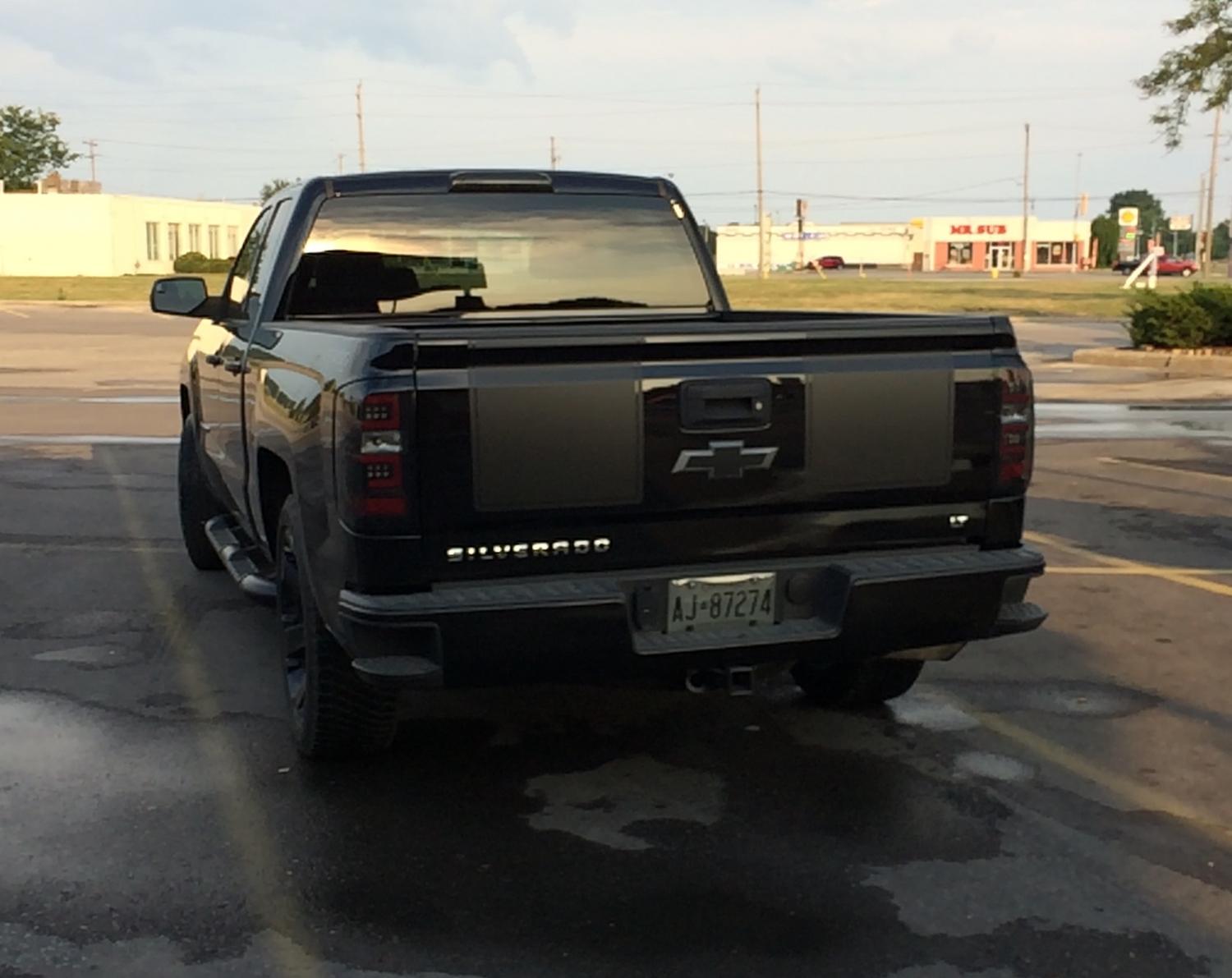

I have the recon LED 3rd brake light installed and it was super easy plug and play. A little bit of a tight fit but it fits good. Has weather strip already on it just need to take the tape off the side that sticks to the cab. The LED brake lights from them are also really easy plug and play. In my opinion recon is the way to go just for how easy it is to install. They had the customer in mind when making these lights. And they look awesome!
do you have photo's on your truck ???
Thank you. first photo's looks good .
No problem and Thanks lol. Keep an eye on their Instagram page, they have sales fairly often.
