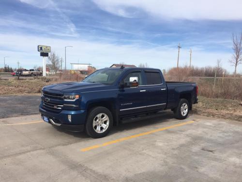

I just had the tow mirrors installed on my 2016 LTZ Z71 1500. the Part numbers above are correct. I had my dealer in stall and i'm pretty sure they had no programming to do and everything works. Make sure to get the harnesses as well!
I had the DL3 Power folding mirrors before.
4360841616ab68b62744aea315e04ac3_zpsfvjy
I purchased the chrome kit on eBay, including the harness. Did the install myself, 2 hrs, pretty straight forward. I had dl8 before. My shop color matched the caps. All the lights work.
