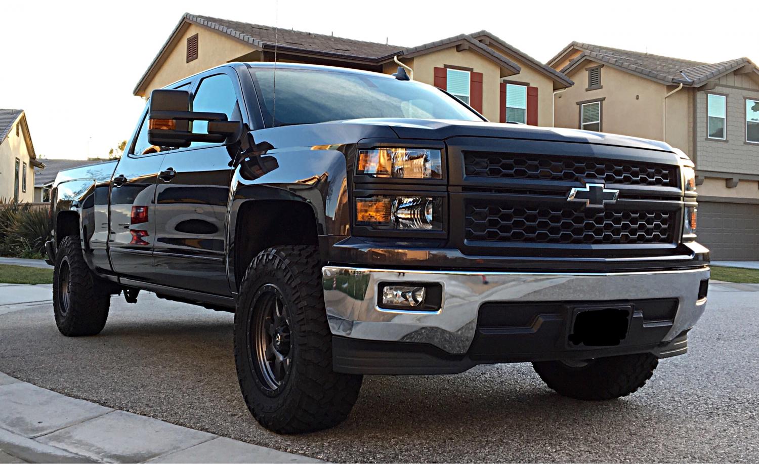

Installed my mirrors last week. As of right now I only have the power and heat working. I'd like to get the harness so I have the turn signals working.
Got the mirrors installed today. Full functionality! the L.E.D. markers and signals are surprisingly bright at night.
Fantastic! Mine are on the way and I have the same truck as you, built the same month.
