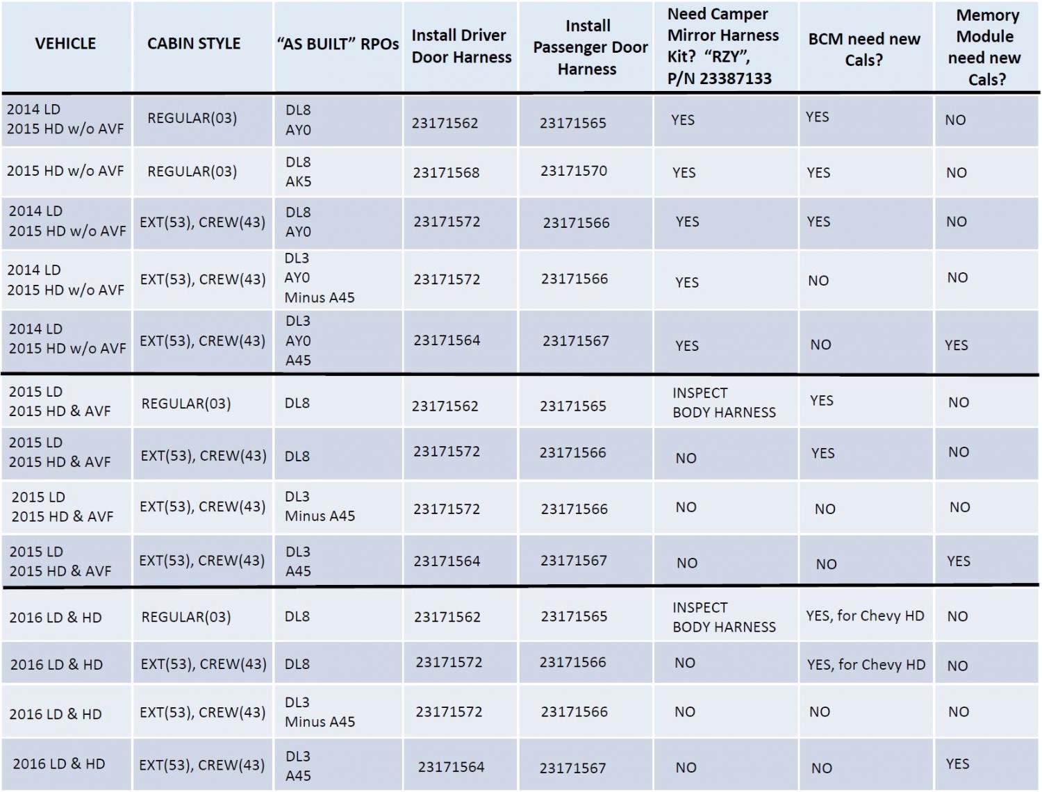

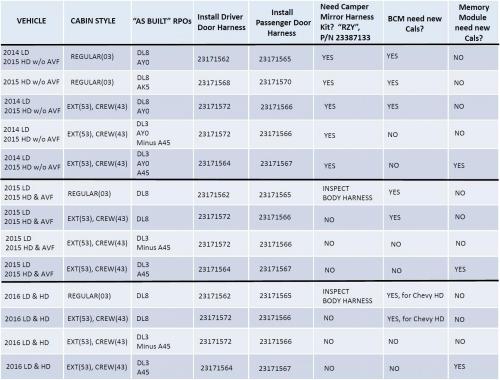

I read through this entire thread and "think" I understand what is involved in swapping the mirrors on my truck, but wanted to ask a few questions just to be sure.
I have a 2014 Silverado 1500 double cab (LT/Z71) with power adjust/heated mirrors.
  1. Has anyone successfully installed power folding mirrors on a truck that didn't originally have them? I see that lots of people who had the folding option did the swap, but what about people who only had power adjust and heat? I know I would need to get the switch, but that's ok.
  2. Assuming I can install the power folding mirrors by adding the switch and tapping into a power source for the folding option, will the other harnesses work to enable the other features such as turn signals and marker lights? I don't have seat memory, so I am not worried about that.
  3. If power folding mirror is completely out of the question, I may go with the manual folding kit. If I get the full kit and the three harnesses, I assume I can get all of the features to work properly. Is there anything that I should be aware of feature wise?
  4. Last question - looking at the chart that tells you which harnesses to order, I'm not sure the differences in the body styles listed. I have the DL8 mirror, but I'm not sure what the difference between the 03 and the 43, 53 body styles are.
Sorry for all of the questions. After reading this entire thread straight through, I wasn't clear on exactly what I can and can't do.
Nick
Nick
The attached photo chart lists out the body styles more specifically.
The attached PDF documents what can and can't be done.
From what I have read, people are saying you can order the power folding mirrors and purchase switches as well to get the power folding option. I'm not positive but that is what I think from reading every thread on it. That will be over $1000 easy. If you aren't partial about power folding, the better option would be the official GM accessory detailed in the PDF.
You can get the non-powerfolding chrome mirrors for $560 shipped from ShopChevyParts or the all black ones even cheaper from other sources. That comes with two mirrors and authorization for the dealer to flash your BCM if you need it. (this chart says you do - 2014 LD, 53 cab, DL8 mirrors).
You still need to purchase the three harnesses (two door harnesses and the RZY harness since you have a 2014) and that will get you manual extend, manual fold, power adjust, heated glass, turn signals, amber running lamp, and white LED cargo lamp (it's not a reverse lamp like some think, it comes on with the cargo lamp button manually).
In regards to the BCM flash, plenty of guys have said they didn't need it for one reason or another, so there is really no telling if you do or don't for sure. GM wants to say you do need it but who knows. At least the official accessory kit comes with authorization for a flash where buying the power folding mirrors separately doesn't.
I hope I helped, that's all I can answer.

Thanks for all of the info! That was a huge help. I guess I really don't know how often I would really fold them, so I am not sure it is worth twice the price. Plus I prefer the black.
I would have to get the three harnesses which aren't cheap, but they really are a nice set of mirrors.
