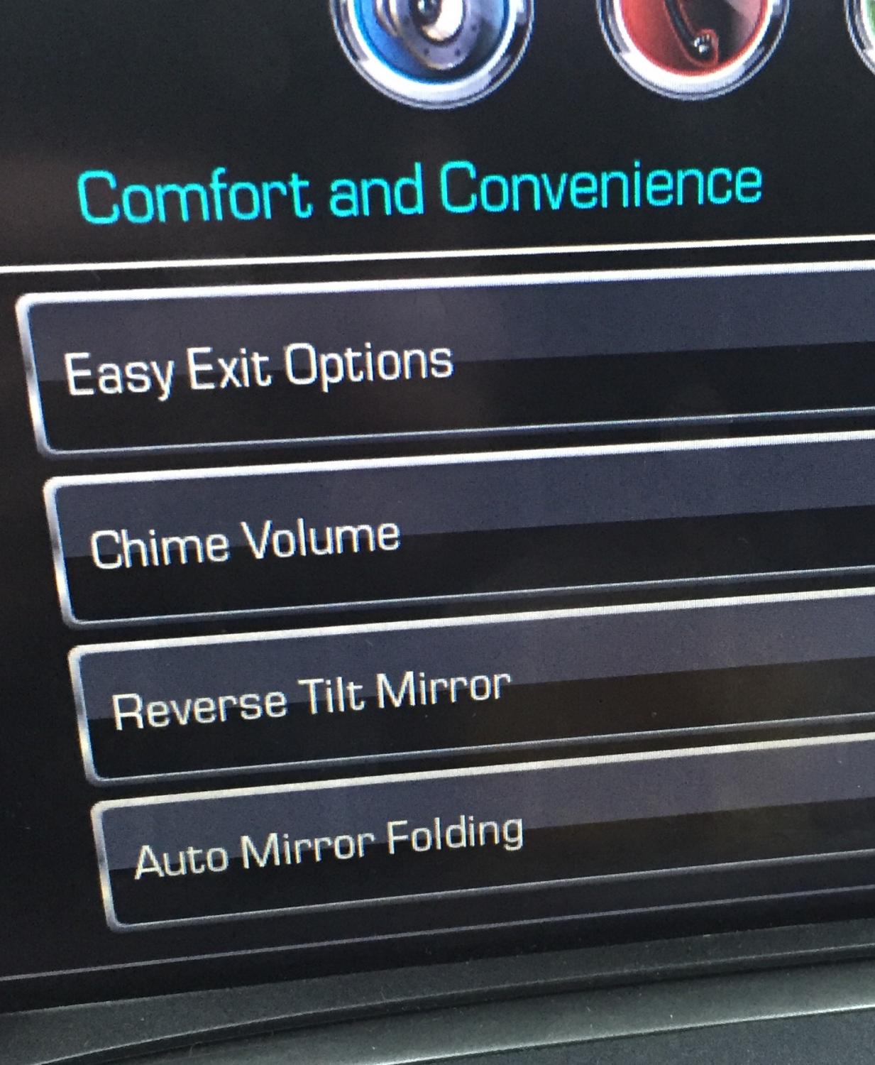

TheRado2016 Posted April 29, 2016 Posted April 29, 2016 Hey all, New here, just upgraded from my ’14 Silverado to a new ’16 Silverado LTZ Z71. Upon placing the custom options, I had ordered tow mirrors. Upon their arrival and after install, they turned out to be non-powered. I immediately researched the correct part number and got it from here (thanks). I gave it to the dealer (AutoNation Chevrolet) and they placed the order. (Mirror 23241465, Mirror 23241469, Harness 23171564, Harness 23171567). The order came through to them and I went back to the dealership to have them switched out. After driving around and trying to learn the mirrors, I am noticing mine will only fold in when you press the button on the armrest. Also, the functionality from the key remote does not fold the mirror in either. I took a picture of my Chevy MyLink to show you the option for mirrors isn’t listed. Shouldn’t this be in there under the settings/comfort and convenience? Is this a fluke? Did the dealership not set this up correctly and forgot to flash or update the system? Since it appears the dealer isn’t on their game, I’d like to go back tomorrow or asap prepared knowing what is needed to fix this. Any advice is appreciated. Thanks in advance.
Shanehooton Posted April 29, 2016 Posted April 29, 2016 Hey. Ya unfortunetly the powered trailer mirrors are only available on the Max Trailering package...which is only available on the 1LZ (non Z71) Found that out when I ordered mine in January. When I got mine I had the trailer mirrors put on, based on the part numbers in this thread. I just checked my convieneice settings and the setting is indeed there for the Reverse Tilt Mirror and Auto Mirror Settings. I am guessing they didn't do the BCM Updates... Does your memory function work for your driver 1/2 recall?
TheRado2016 Posted April 29, 2016 Posted April 29, 2016 Hey Shane, I was hoping you were going to reply to my post. I saw your post about ordering the truck and said that's totally me as well. Mine's the 2LZ package. I am hoping that this "BCM Update" is the fix. When I first picked up the truck, the options you show were not listed at all. The Memory buttons work for the seats and mirrors. Just don't have those options on the MyLink and no folding option on the key remote. It's an LTZ that should be there! Phoning the dealership today to see what they say. Hoping no further hardware is required. PITA.
Shanehooton Posted April 29, 2016 Posted April 29, 2016 I wouldn't think any additional hardware is required... unless they didn't actually change the harness out in the doors. Do your backup Lights and the orange clearance light work properly?
