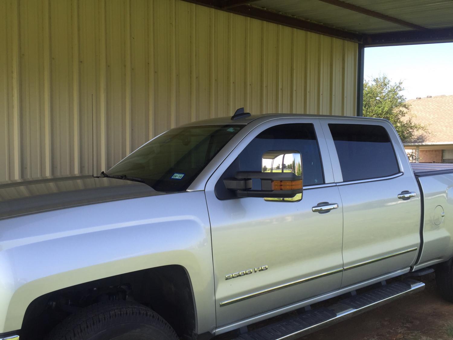

sorry but what truck bed cover is that and do you recommend it?
It's called a Bakflip. I like it. Full access to bed if u need it and keeps things dry and fairy safe. Ine is a 4 fold and aluminum. No flapping like the fabric ones. Can fold over in half and stand on it.
