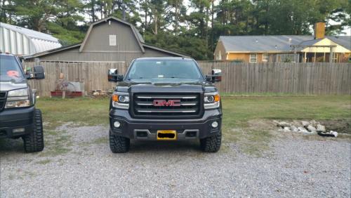

Just bought this new 2015 with the towing option. I was not looking for this option but it did not bother me. I actually wanted another truck they had but I did not like the ride of the 20's. Plus I would rather spend the extra on a useful option like the tow package that had additional cooling. Even though my boat only weight $3600 lbs...
The mirrors must create the largest blind spot on the planet! They look cool at night with the lights are on.

Nice looking truck!
You'll be surprised how quickly you adapt and no longer have problems with the mirrors.
(kinda like adapting to the A pillar location when first operating an unfamiliar vehicle)
