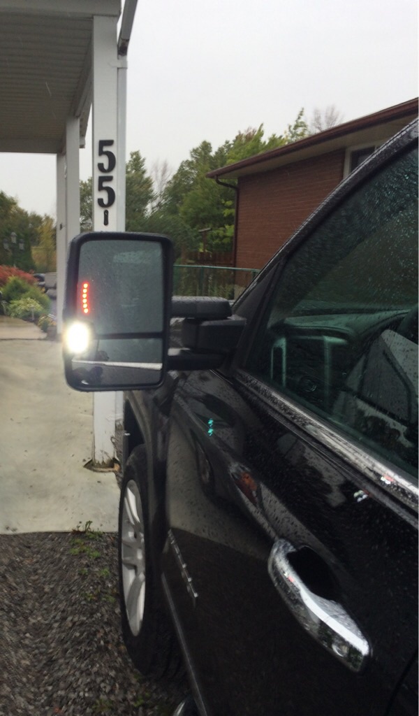

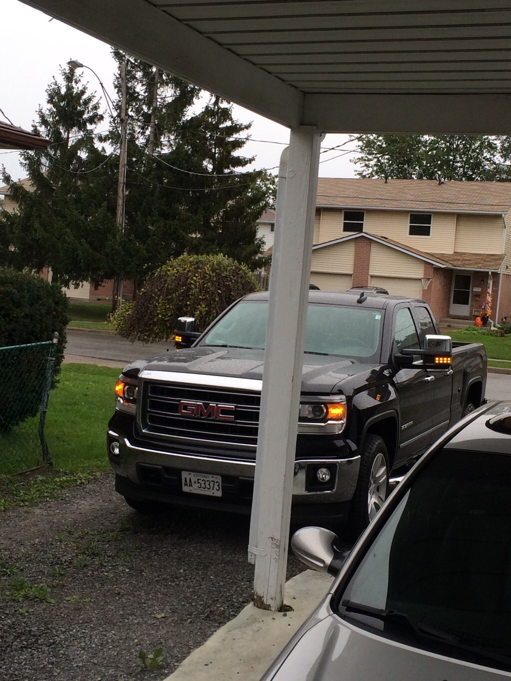

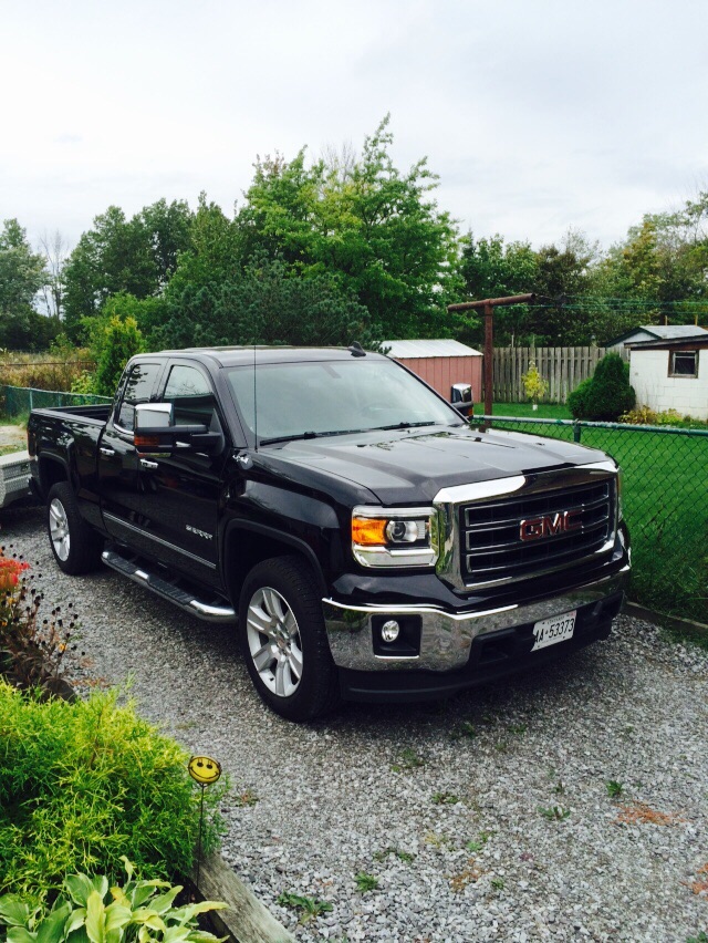

I ordered the Chrome mirrors p/n 23372181 with door harnesses, p/n 23171572, and 23171566
Here are some quick pics. Sorry not the best quality pics, took them quick
