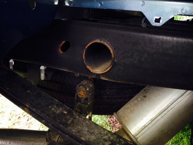

Experiencing the same issue. Purchase date July 2014 (less than 200 miles), lots of rust and GM states this is normal. This isnt normal for chassis coating to just fall of especially when purchased new. This is ridiculous!
I don't understand why there is so much inconsistency in these trucks, the 2014 CrewCab loaner they gave me has a build date of 4/14 and the undercoat is perfect.
I had the same experience, until I called GM.... Then I got my entire frame re-coated, and undercoated. It looks perfect now and the new finish seem MUCH more durable than the original.
What number did you call? who did you talk to and what did you say?
Do your research on this thread and the couple of others on the same subject in this forum (read ALL the posts). The rusty frame is covered under warranty IF YOU bring it up to the dealer service dept - see info and pictures in the posts, including materials for the dealer to use and directions on how to do the job plus direction saying the repair to be done under warranty. Same thing for the rust rear diff - all covered in these posts - with pictures and dealer instructions.

The chassis is part of the frame. See my edit on the post above yours. My point is that it's all BS. Any GM rep that tells you having bare metal and rust all over the frame is normal obviously is full of shit and point them to the chevy and GM media sites. They are making false advertising claims on these trucks.
I quote:
"Extensive and improved chassis corrosion protection that enhances the trucks appearance and lengthens the life of underbody components"
How does rust all over the frame enhance the trucks appearance?

I dropped off my truck last Tuesday night for the repair. Almost a week now and they are still working on it. I'll post an update once I get it back.
