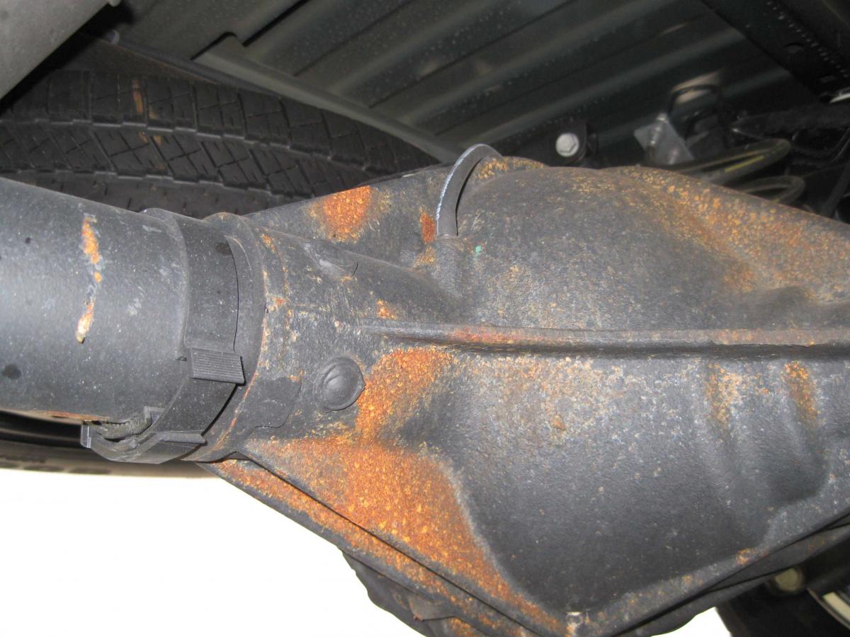

Below are several photos of the frame and suspension of my new 2014 Silverado Crew Cab with a build date of 12/13, purchased 6/9/14. Should a new truck have rust showing already?? Anyone else seeing the same thing? Am I being ridiculous? Anyone got a quick fix? I was thinking a using a wire wheel and some black spray paint.

My build is 11/13 and I have similar spots. I just used a but of bedliner spray and hit it. Didn't feel like bringing it to the dealer.
My truck build in August of 2013 has some similar spots. To me they arent worth taking tot he deather for a fix. I might do what jeffsig did and hit them with some black bedliner spray
Yep I have the same spots. Build date 9/13, purchased 2/14. It's complete and utter bulls***t that a new truck (even SITTING ON THE LOT) has rust on it if you ask me. But with that being said, I think it will only be a cosmetic issue going forward. I did take mine in to get fixed and here's what I learned:
1) There is a recall out on this issue and they can use your VIN number to check if your truck is included or not. By the looks of your truck, it looks EXACTLY like mine and my truck was NOT included with this recall. The dealer did claim they "pushed my truck through under the recall anyway." But they didn't do a great job at all. Read #2 and #3 below.
2) Those that have gotten the official recall repair done have had their truck in the shop for a few days and the dealer does an extensive process of removing the existing peeling wax and re-coating the frame with a special 2 part coating system that looks like the original factory wax coating.
3) In my case, the dealer kept the truck for 1 day and sprayed some 3M rubber coating crap on the frame that looks and feels nothing like the original wax coating.
Newer trucks built in Spring 2014 and on have had this problem corrected and the factory coating is much better and thicker. Guys like us are basically screwed and stuck with rust spots on our frame. At this point I've decided I don't care anymore. I'm getting rid of this truck shortly after it's paid off which will be long before any rust becomes a structural issue.

My frame is coated with a thick grease type shit. I mean thick. I put my reciever hitch on this past weekend and that crap was smashing out from between the hitch and the frame. I didn't notice any rust spots while I was under there, but I didn't look over every square inch of the frame. If I did and it was in an accessible spot, I'd probably hit with some wd40, a wire brush, and then paint it with black grill paint or something equivalent. I don't think it could rust enough to hurt the integrity of the frame for as long as I own it, so no sweat.
