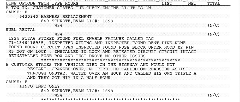

The dealership fixed the truck by the end of the day on Monday and said that it was bent pins and a "block not properly locked down" from the factory. I picked up the truck on Tuesday. Nice cashier wasn't there, but replaced by someone who probably had problems with her broom on the way to work... Just saying.

Here is what the service order looked like... It almost could be French because it is quite difficult to understand. Whatever they did, the truck seems to be OK. It will take a while for me to really trust it, but it's still a rather nice truck... Knock on wood....
