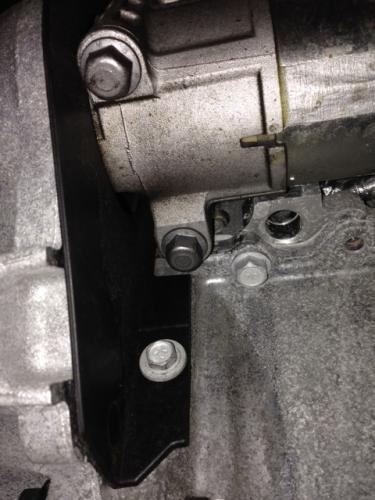

I crawled under my truck and found the source of my noise. it was a plastic shield by the starter and fly wheel.
I loosened the bolt and adjusted the shield and noise went away.
