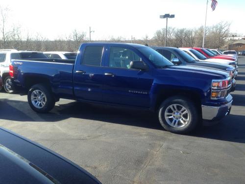

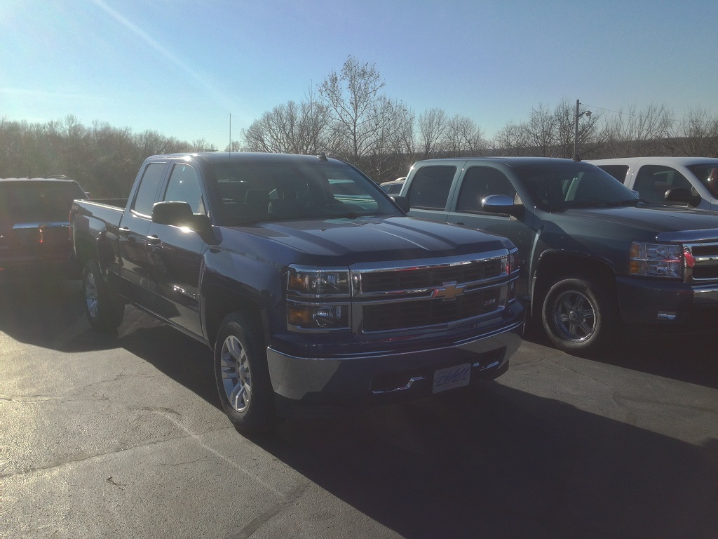

Hey guys,
My local dealer got a used '14 LT w/Z71 (I think - more on that in a bit) in that I'm interested in. Unfortunately they were closed today so I couldn't get inside it to look for RPO codes. Anyway, the grille is the Z71 grille but it has the regular 4x4 red stickers on the box? All the new Z71s I've seen have the Z71 stickers out back and on the grille.
Pictures attached.
  • Replies 37
What probably happened is that it's just a normal 4x4 and someone replaced the grille with a Z71 grille. No different than the Sierra owners replacing the grille with the All-Terrain grille. Did you happen to look inside? A real Z71 will have the Z71 logo on the tach gauge face. It will also have Rancho shocks. Other stuff also but those will be what you'll be able to quickly look at.
As mentioned earlier it should have the Z71 tach, Z71 bedside decals, red over white Rancho Shocks, and the skid plates. It should also have Z71 door sill plates, a Hill Descent toggle switch on the far right of the center stack, and high capacity air cleaner.
It has wheels and 4x4 stickers consistent with the LT w/1LT package. The LT w/2LT (Z71) package, normally have the Z71 stickers on the bedside, and the 18" aluminum wheels without the slot running through each spoke.
I disagree with the earlier comment about it being the same as the Sierra owners installing an All Terrain grille if they started out with a Z71 package. They both have the same Z71 package. The All Terrain also has additional cosmetic upgrades, but no mechanical advantage. Standard 4x4 SLE package with the All Terrain Grille sorta like the LT w/1LT 4x4 pictured above with the swapped out Z71 grille? Still not really the same as there is no Z71 or All Terrain badge designation in the grille. Just a different grille.
I have the the All Terrain Grille in my Z71, with the Z71 Badge added for a unique look, but I also have the Z71 package to back it up.
I just traded in my "4x4" LT truck with a Z71 grille. It happens.
Someone could have added the 4x4 sticker or it could have been ordered from the factory with the 4x4 sticker.
The sticker added is my guess. As everyone else has said, a quick look inside or at the shocks will tell the story.
Super quick and can check from outside looking in...... hill decent button
Everything else could be added but as far as I know...not the button (and have it work)

I think that most real Z71's have the 'brushed aluminum look' interior trim.
I wasn't comparing Z71 to the All-Terrain. I was simply comparing someone doing it for looks. It just looks like someone with a regular 4x4 and just switched the grille for a Z71 grille. Same as the non All Terrain Sierras owners switching the grille for an All Terrain grille. Not mentioning features, just the grille.

The Z71 wheels/rims are also different. Those look like non Z71 wheels.
