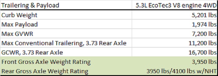

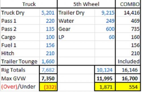

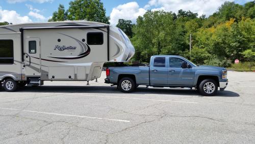

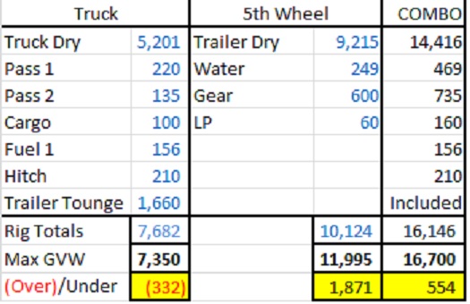

My rig is a 2014 Silverado 1500 Double Cab 5.3L 4x4 3.73 Max Tow and a 33 foot Grand Design 303RLS 5th wheel. I am curious to hear what some of you think of the chart below. I installed a set of Timbrens to level out the rear and help mitigate the bouncing.

Please note: The standard rear gross axle rating is 3,950lbs. But the chart shows we get another 150lbs (4,100lbs) with the 3.73 rear-end. So my computations for Max Gross Vehicle Weight with the 3.73 is a total of 7,350. Though I am 332 lbs over max payload, I am 554 lbs under max combined weight.
By the way, for those of you who follow the 20% rule-of-thumb for 5th wheel hitch weights; remember that formula assumes a long overhang, greater lengths and trailer axel position. My 5th wheel is a short nose at 33'. Granted, I am indeed pushing it. If I was towing this set up full-time or a majority of the miles the truck is driven, I would be going out to get a 2500 immediately.

Refigure your fuel 26 gallons at 8 lbs. a gallon is way more than 156 lbs. and in the end your overloaded end of story, nothing to talk about.
Will your truck pull the camper.....yes.
Is it safe to do so with that truck......not really.
You're overweight, and really pushing the limits of that truck in IDEAL conditions. Add any weather to that, and it's a sure recipe for disaster. You stated in the beginning that you run aggressive and fast with the trailer.....that's a terrifying sight to see. You shouldn't go over the speed limit with your trailer, and you should go under the limit with your setup. What is the max speed rating on your trailer tires? I'm fairly confident that it isn't more than 65mph.
Hate to burst your bubble, but you should have got a 2500. I do about the same same hauling as you, and my 2500 was the perfect combination to SAFELY do everything that I need it to do.

Gasoline is 6 lbs per gallon. Water is 8.3lbs per gallon. That's why gas floats in water :)

gasoline is 6 lbs per gallon, actually it can go up or down depending on temp, but 6 gallons is pretty good number to figure.
Couple things to think about. I have the same set up in 14 max tow, im pretty sure the max tow was 11,200 or 11,300. only the 6.2l got the 11,900 rating, if unsure check your door jam. The 15 model in the same specs is only 11,000lbs. It looks that you have done your homework though. But My guess is you may have underfigured the gear in your trailer, my guess is probably double that figure, pots and pans, clothes, food, bikes, cmap equipment can easily bust 600lbs. Another thing to think about is how RV and fifth wheels in general can act like sail.
Personally your over weight on all accounts and being dangerous to not only yourself but others on the road, im not saying that in a mother tone, but thats reality. If something were to happen and hopefully everybody walks away, but if they dont liability and insurance will eat you alive just by looking at that set up.
