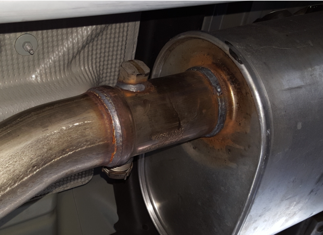

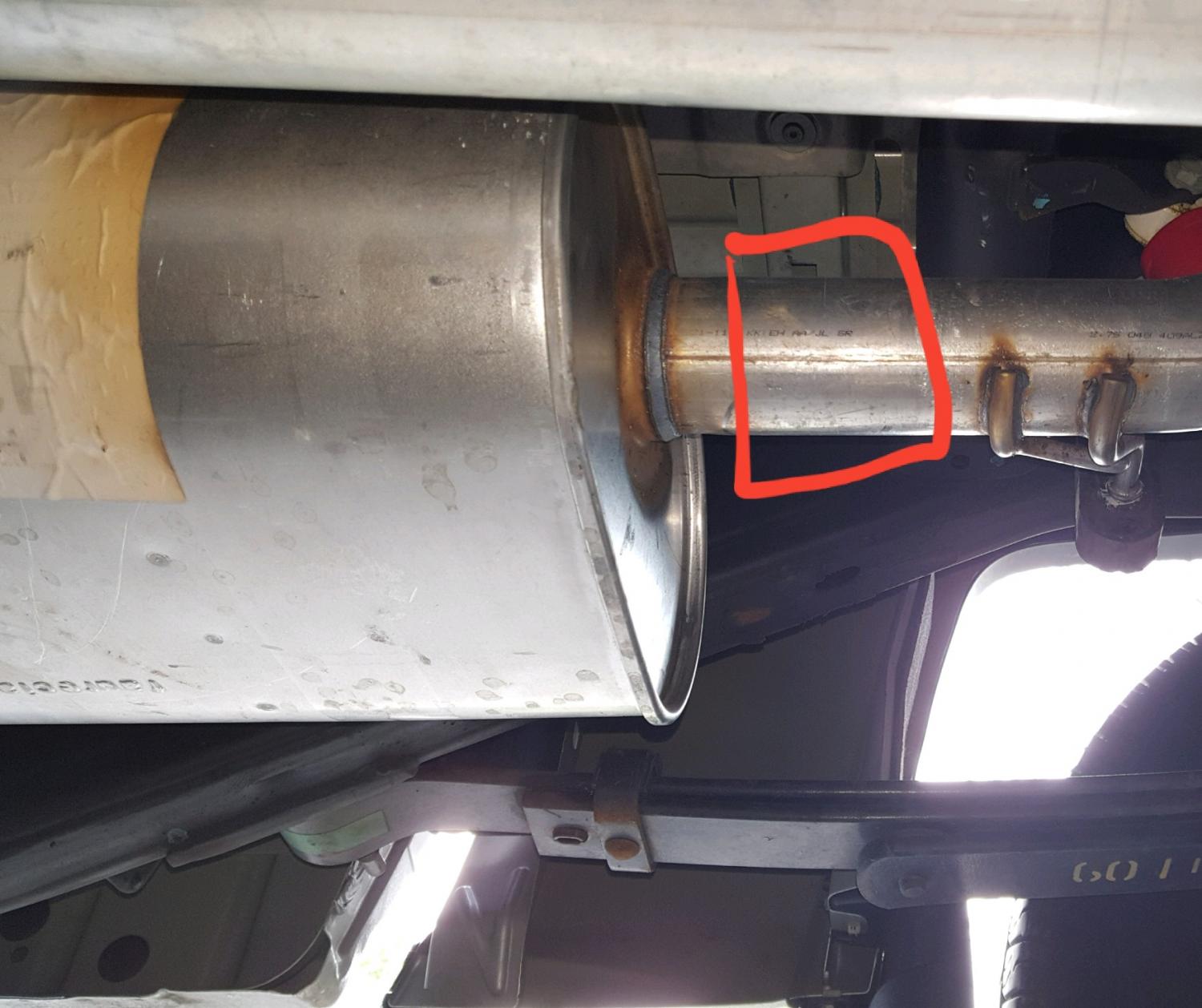

Lemontree Posted May 1, 2017 Posted May 1, 2017 This is a picture of the one they installed under warranty. I put about 500 miles on it and did not notice any drone noise in V4 mode.
Justin101714 Posted May 2, 2017 Posted May 2, 2017 Absolutely a bulletin on this concern. I've replaced tons of these exhaust systems for this problem. You don't have to bring them anything, they should be smart enough to search Service Information and find it. Make them do the leg work. Sent from my iPhone using Tapatalk
sk Posted May 2, 2017 Posted May 2, 2017 (edited) This is a picture of the one they installed under warranty. I put about 500 miles on it and did not notice any drone noise in V4 mode. That is behind the muffler where the square flapper used to be. Look in front of the muffler. If they installed the new style you will have a round flapper before the inlet to the muffler. Edited May 2, 2017 by sk
Lemontree Posted May 2, 2017 Posted May 2, 2017 See that. You learn something new every day. I just climbed under it and it's in the front.
