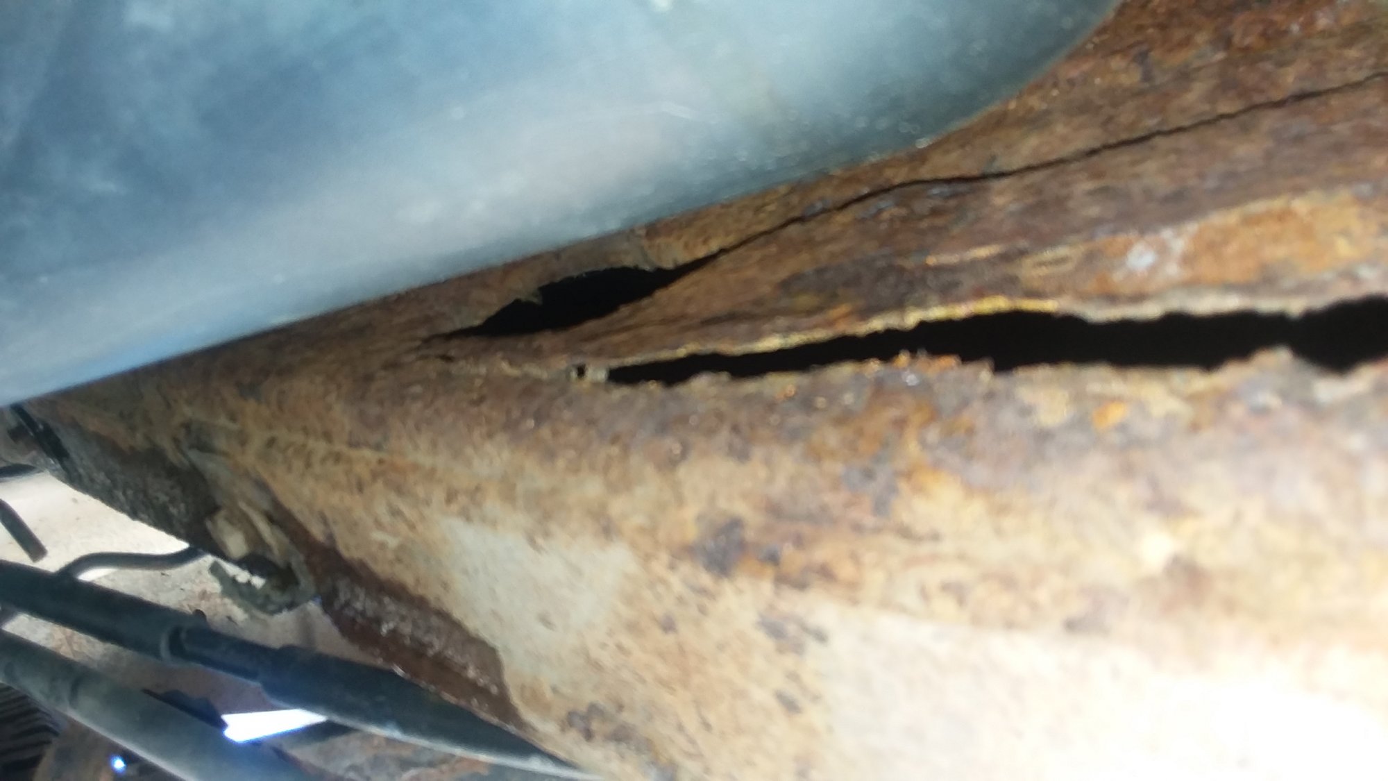

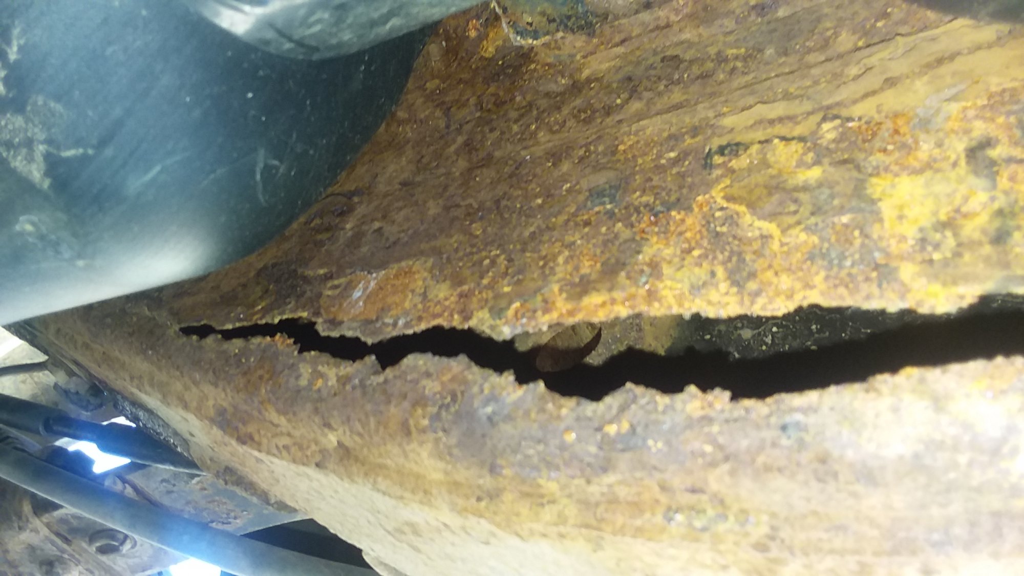

Lucky you folks just have noise . My 2013 missed warranty by 4 months and 400 miles. Huge hole in left frame rail at 100800 miles .
Wanna trade
