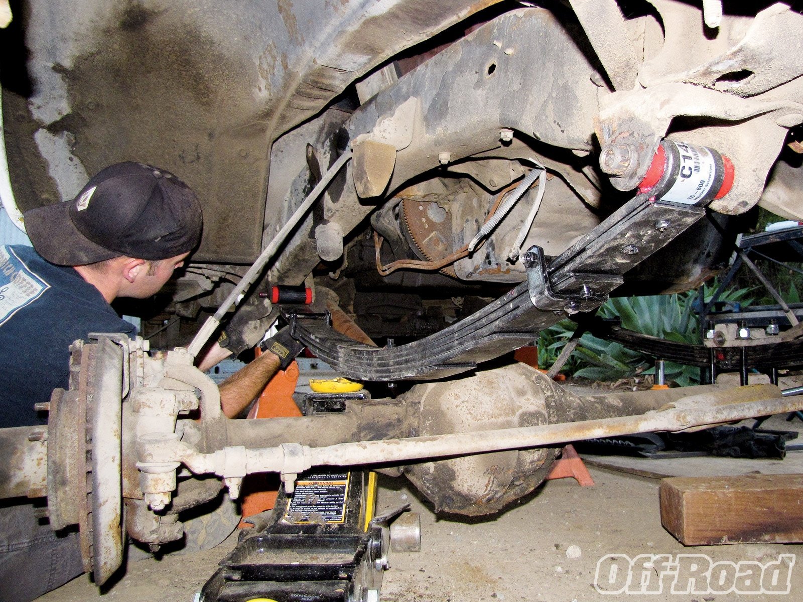

interesting you say that, my old 1990 suburban never had any noise issues, but if you look at an older GM truck, the leaf spring stack from an old suburban or blazer you'll see GM added a bracket that wraps around two or three leaf to what i assume keeps them from sliding sideways. i'll see  if there is a picture on  Google images

the part we need to add is called a Rebound clip..
Does adding this clip compromise the suspension in any way? This seems like too simple a fix.
Alot of guys on here have tried those to help vibration....I tried it and it helped neither. I did only clamp the portion of the leaf spring in front of the axle.

i wouldn't recommend the pepboys rebound clips as they are a very sloppy fit and require welding to keep from loosening up. you need to go to a leafspring manufactuer or spring shop, and have them correctly install the clips. so they fit tight and have no slop room, they really should be riveted on, then torque the clips bolt together
