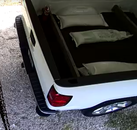

I read most  of the replies on this topic. I hope I did not overlook this diagnostic question: "Has anyone tried placing a couple hundred pounds of weight in the bed of the truck?"
I placed some sand in the back of mine, rides a whole lot smoother. Seems quieter, too.

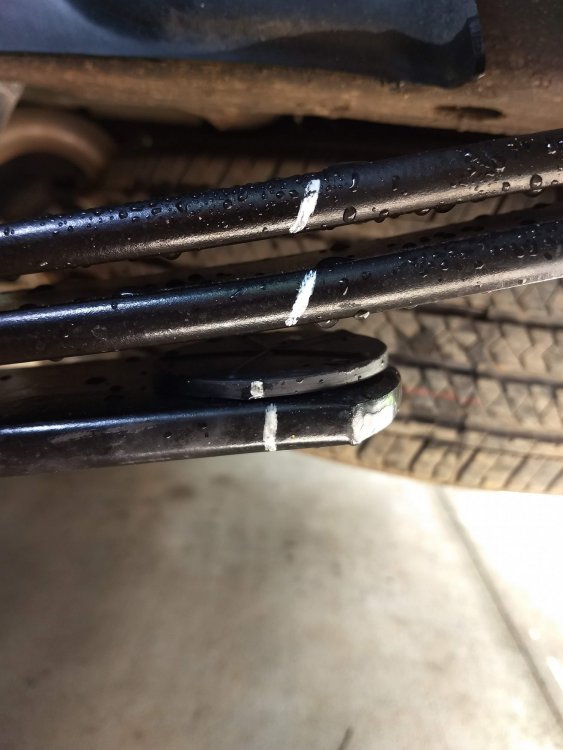

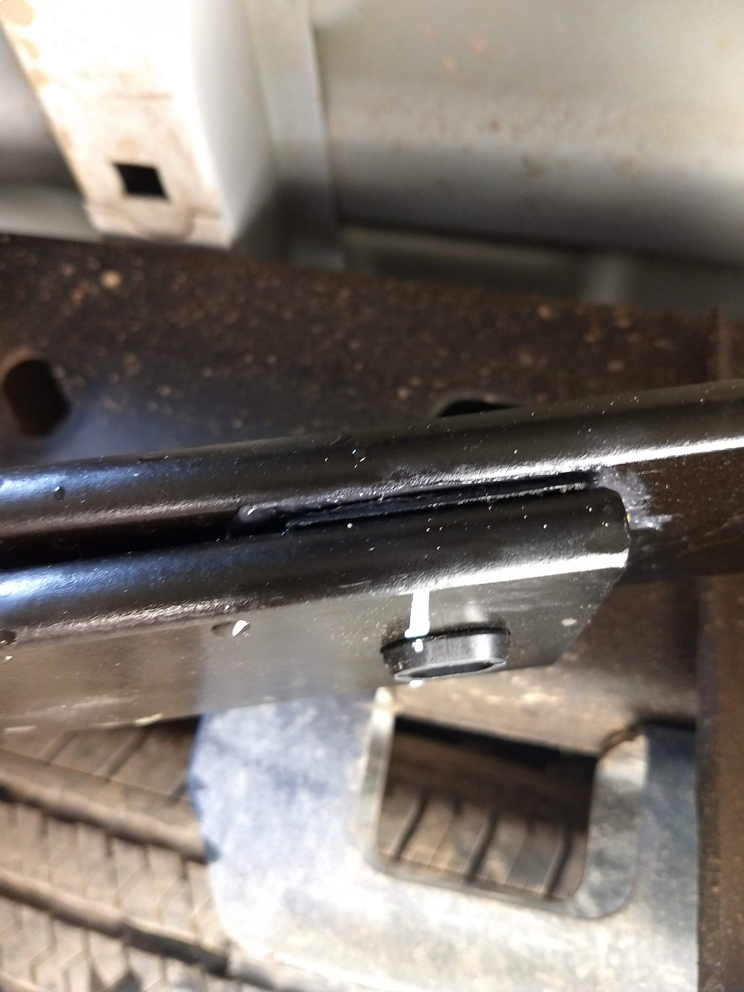

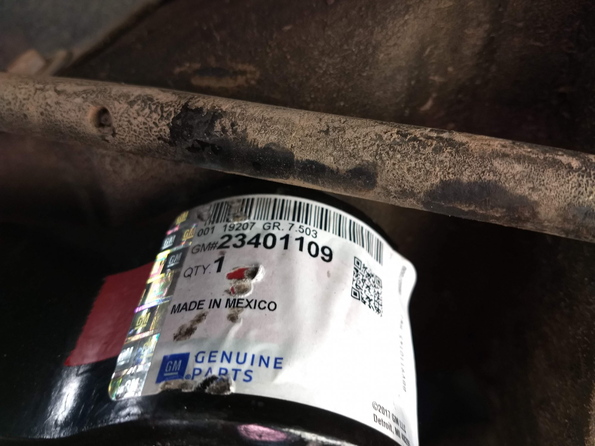

As promised here are the new springs and part number.  Looks to be the same part number with new insulators types and locations etc..
Guess what looks like is in between the two top springs now!!!!!  Looks like a RUBBER PAD!!!!!!  Looks like the folks that have been putting bike innertubes between their springs are geniuses and GM finally has a new spring out with what looks like a rubber pad both in front and back of each top two leaf springs.
  • Manufacturer:GM
  • Part Number:23401109
  • Part:Leaf Spring
  • Replaces:23488047, 23287270

Well, I drove it home and no creaks, pops, or clunks.  But they are new, shinny and clean.  Time will tell.  I swerved the truck from side to side at low speed which used to pop and clunk like crazy.  None of that now.  But again, brand new and clean springs.  But the insulators are different etc...

We'll these have different insulators etc... So we'll see

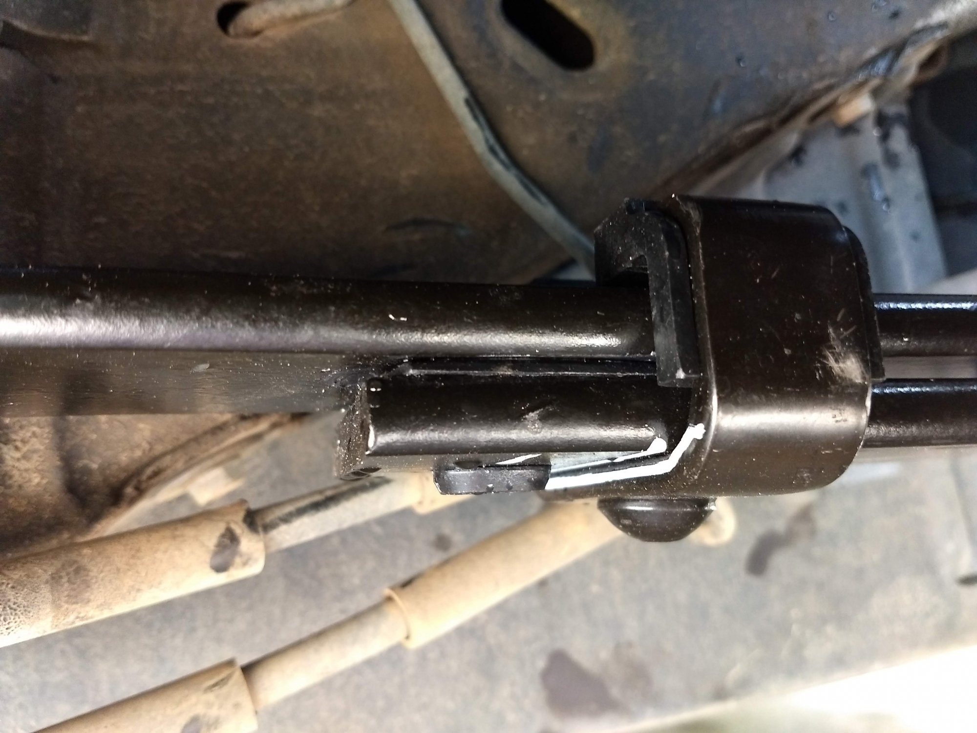

If you find the other post in the main forum, there's a GM tech that mentions the new insulators going in without replacing the whole springs.
My dealership said it was just as much labor to do either one and easier to just replace them with whole new if GM approves it. Well, they approved it for mine I guess

For anybody following this topic, I can attest to the inner tube rubber solution. Mine was making all kinds of noises and banging for a while now, and today did the rubber in between the springs and is absolutely amazing how quite it is now compared to before.  Only took about an hour and was pretty easy, just pry the leafs apart slide in the piece of rubber and done. This should be a permeant too vs the greasing fix .
Yes the dealer could have likely fixed or replaced under warranty but for something this easy and cheap I see no reason not to DIY and save the time and hassle of going to the dealer possibly multiple times.  I see no reason it will ever reoccur either.
  • Manufacturer:GM
  • Part:Leaf Spring
does not look any different than mine?  I have 2016?  confused..........
