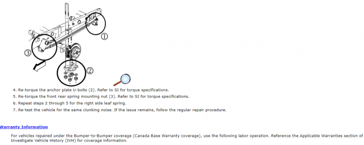

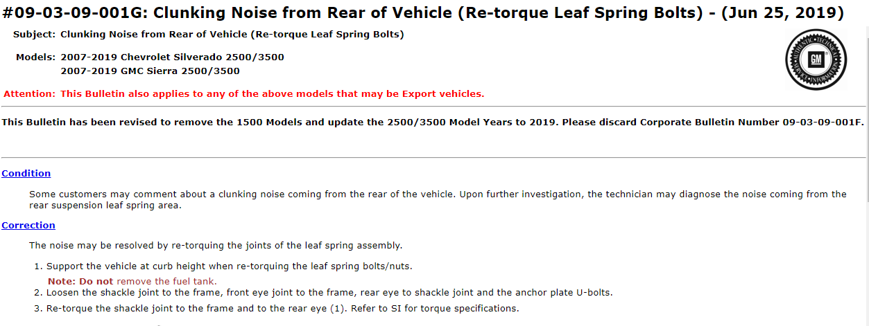

#09-03-09-001G: Clunking Noise from Rear of Vehicle (Re-torque Leaf Spring Bolts) - (Jun 25, 2019)
Good post! I’d have to check the work order from the 1st time I brought mine in but I think this bulletin is what they performed. They said there was a bulletin on it and GM told them to loosen and re-torque all the bolts on the rear suspension. In my case it didn’t help.
