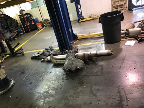

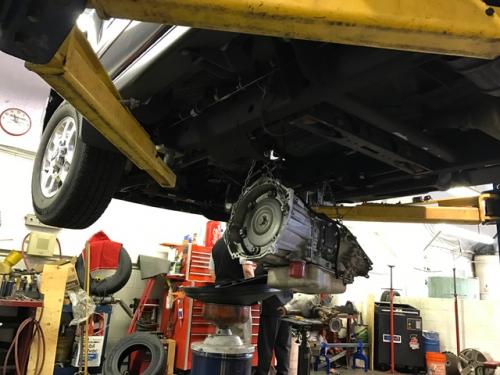

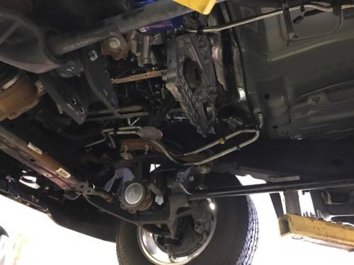

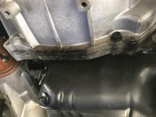

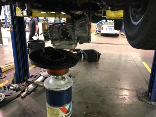

2015.5 2500 HD LTZ with 22,000 miles. In the shop for a week. Replaced upper oil pan gasket.
post-143388-0-68298200-1478236387_thumb.jpgpost-143388-0-16907700-1478236387_thumb.jpgpost-143388-0-69003100-1478236386_thumb.jpgpost-143388-0-18774400-1478236386_thumb.jpgpost-143388-0-69744800-1478236385_thumb.jpgpost-143388-0-17082200-1478236385_thumb.jpgpost-143388-0-77875500-1478236384_thumb.jpgpost-143388-0-22567900-1478236384_thumb.jpg
