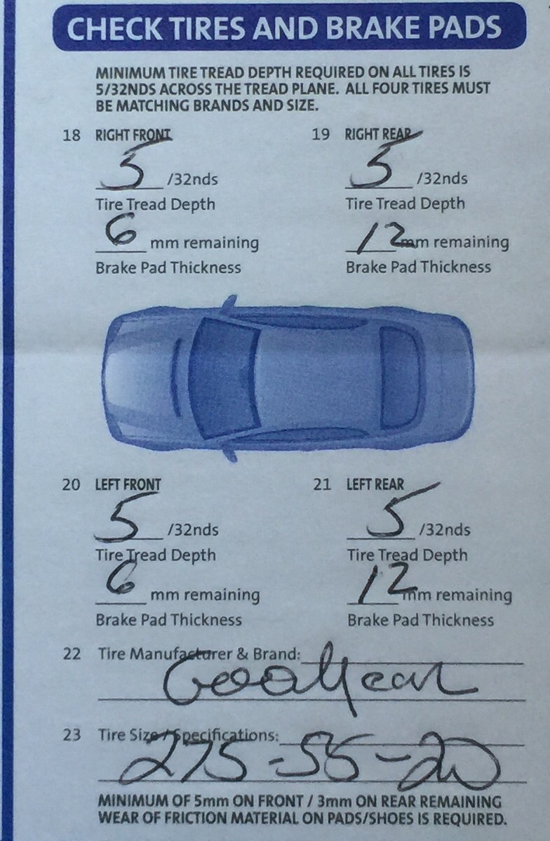

I agree that the driver does play a significant role in the wear of the brakes. I did more digging into this while I was on the phone with GM Corporate. I looked deeper into the paperwork I have and the dealership received the truck back in the end of October 2012 with 16,077 miles and the certification for the "certified pre-owned" was done on April 21, 2014 with a mileage of 37,930 and they did a PA inspection sticker of May. The actual mileage I purchased it was 37,995. So they drove 21,853 in the matter of 18 months or so. The certification states the front pads were 6mm and the rear were 12mm. From the time I purchased it till March of this year when we first noticed the brakes starting to act up, we put roughly 4,000 miles. When we took it in for inspection towards the middle of May was 5,500 or so and they passed the truck for inspection! Unfortunately, I don't have written documentation of what the millimeters were on the pads at that time. I just don't understand how they could've passed the truck for inspection, especially when we asked them to look into the brakes! Soon there after, the brakes got to the point where we needed to get them done! I don't understand how original brakes can only last 44,000 miles or so!
Passed the truck for which inspection, the Certified Used inspection process or the PA state vehicle inspection?
The minimum limit for pad thickness on Certified Used is 5mm for the front and 3mm for the rear. Looks like they just skirted by on the tires though, as the minimum is 5/32 of tread.
PA vehicle inspection regulations state that pads or shoes can not be making metal to metal contact.
When they did the brake inspection for you what was the pad thickness at the time?
The pic above was of the "172 point inspection" for the "certified pre-owned" classification back in April of last year. I believe they did the PA state inspection at that same time, since that was the month sticker on it when we purchased it. I looked through my documents/bill/receipt for the inspection they (O'Neil Buick GMC in Warminster, PA) did this past May and it did not have the breakdown of the pads or what the rotors looked like. I will be contacting them on Monday to get this information. The mechanic had to of written it down somewhere!
