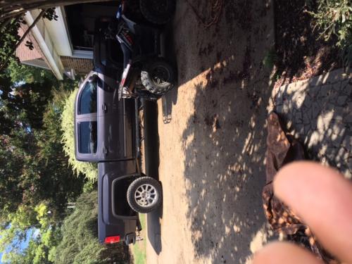

I'm sure this pic will be disoriented. Anyone know what's up with that? 7.5" rc kit for magneride on 295 60 20 stt pros. 1.75" rear spacers.

Trust me the 295 60 will fit with stock offset but will rub on the uca and the sway bar. Add a spacer to correct that and your rubbing the rear of the fender well hard. With the shape of the wheel wells on this truck it takes more lift than I'm used to using to get the clearance to an acceptable level. I feel like I will have to trim a lot to fit much more than a 35.
I am just about to order that exact same tire. How do you like them? How is the road noise. I'm surprised you are rubbing with a 7.5" lift but I know it's the offset. How big of a wheel spacer are you running to clear the ucas? I'm going to run these on stock 20s with a 3.5" lift.
No I'm sorry if I was hard to understand. I'm not rubbing now on the 295 60 20 but When I go to a 36-37" tire I will most likely have to trim heavily. I didn't like the stt pro at first but I think it was due to the shop overtorquing the lug nuts. Since i have torqued them evenly and installed the hubcentric wheel spacers (a few burnouts didn't hurt either). I love them
