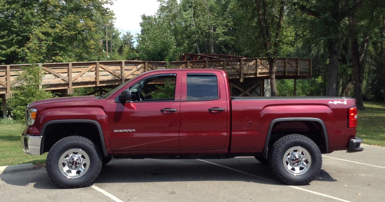

With the 4.5 zone lift, how much are the tires gonna stick out the side with the factory 20s, I want to keep then under as much as possible, any thoughts on the 3.5 rough country with control arms?
That is how far the stock wheel and 35" tire will protrude. If you want less why not go with a thinner than 12.5" tire.

How would a 285/65r20 look under that zone 4.5, seems ad it should fill it out fairly well and be completely free and clear of any rubbing issues
Well you can fit a 35"x12.5" tire with a zone lift and stock wheel with no rubbing. A 285/65r20 is pretty dang close to a 35" diameter just comes in a bit thinner at 11.2" so it would be close to flush with the fender to be honest. Would stick out just a little.

'14 Silverado 1500. 6 inch lift on 35x13.5x20
Did you have to run spacers on the front to keep the stock wheels? And how noticeable is the wider track width in the front compared to the back? I wanna do a 6 inch super lift on mine but I wanna keep the stock 20's and I'm worried the tires sticking out more in the front is going to stand out bad....help me out man lol I'm torn
So when you use the stock wheels on a lifted truck, do you end up using a spacer? I want to get a 4 inch lift but keep my stock wheels. I also don't want to go to wide out but at the same time I understand that as the truck gets higher the ability to roll over increases.
