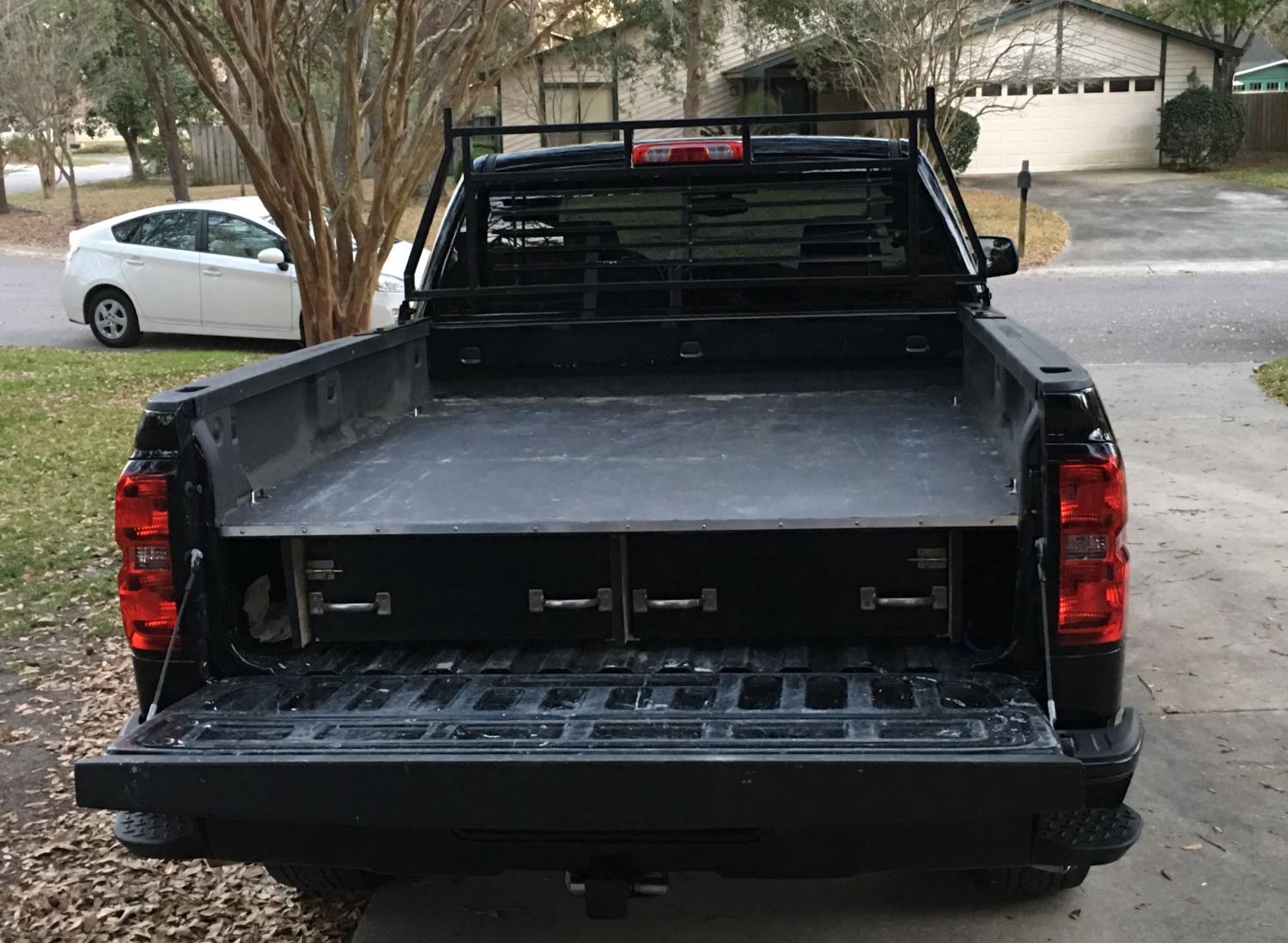

I did my own storage set up and would like to add a inverter off a second battery.
The storage set up pictured below I wish I would have done years ago. I love it.
