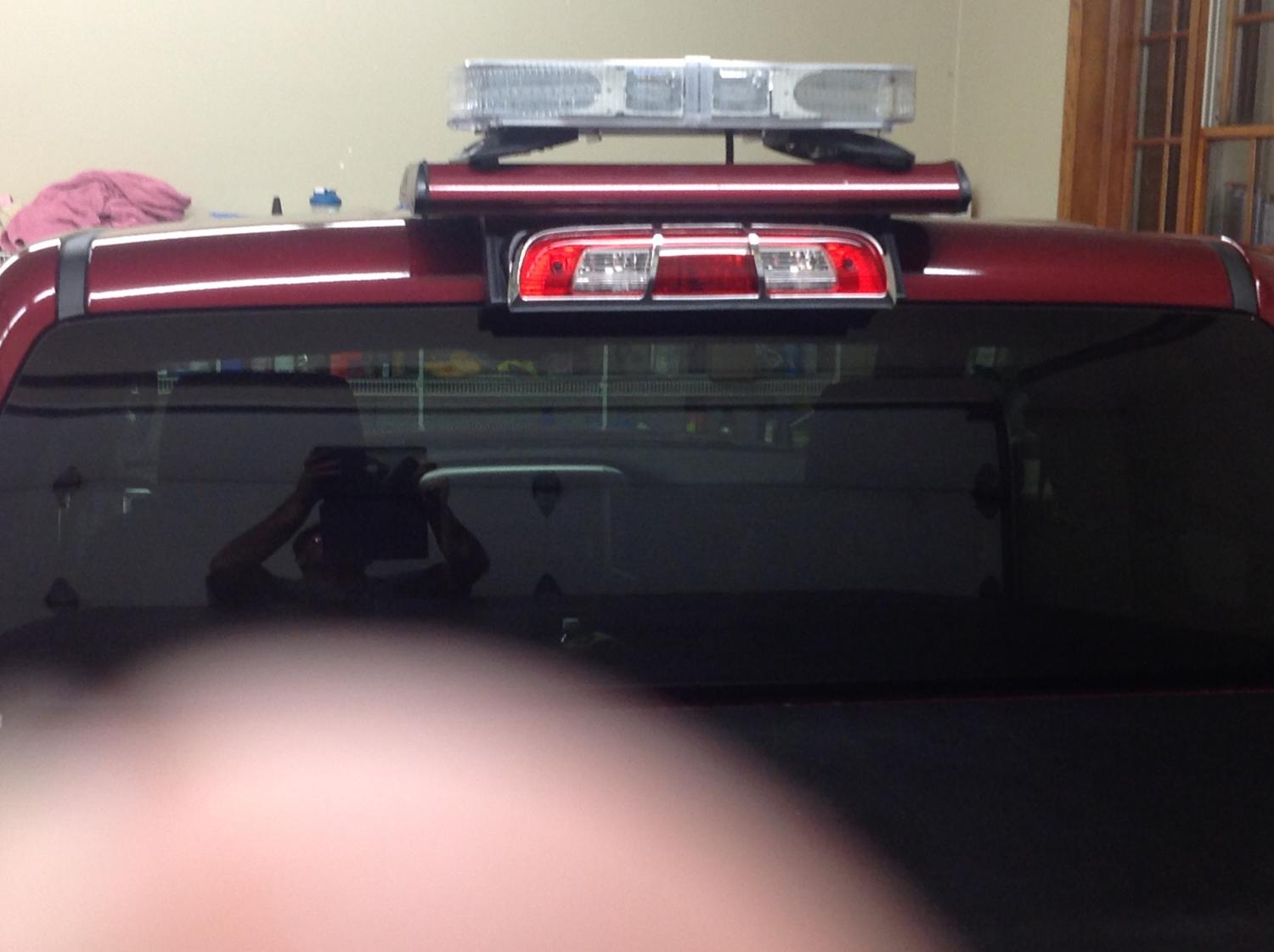

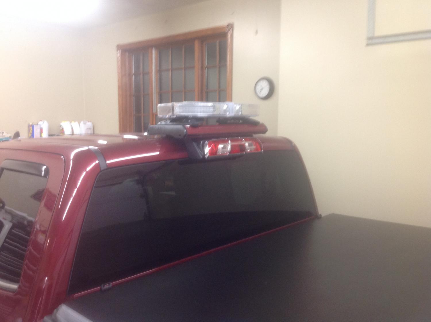

Third pic
Can you give me for information on the way you have it mounted and wired?
Sure.
The mount is made by www.acariproducts.com
Check out their website for mounting instructions. It mounts in the third brake light opening. No holes to drill, and easily removable without any possibility of damage to the truck. By using this unit, the light bar can now be ordered as a permanent mount. No more hi-way blow offs that can come with magnetic roof units.
For a retailer, I would go to www.strobesnmore.com They have everything you need at the best prices.

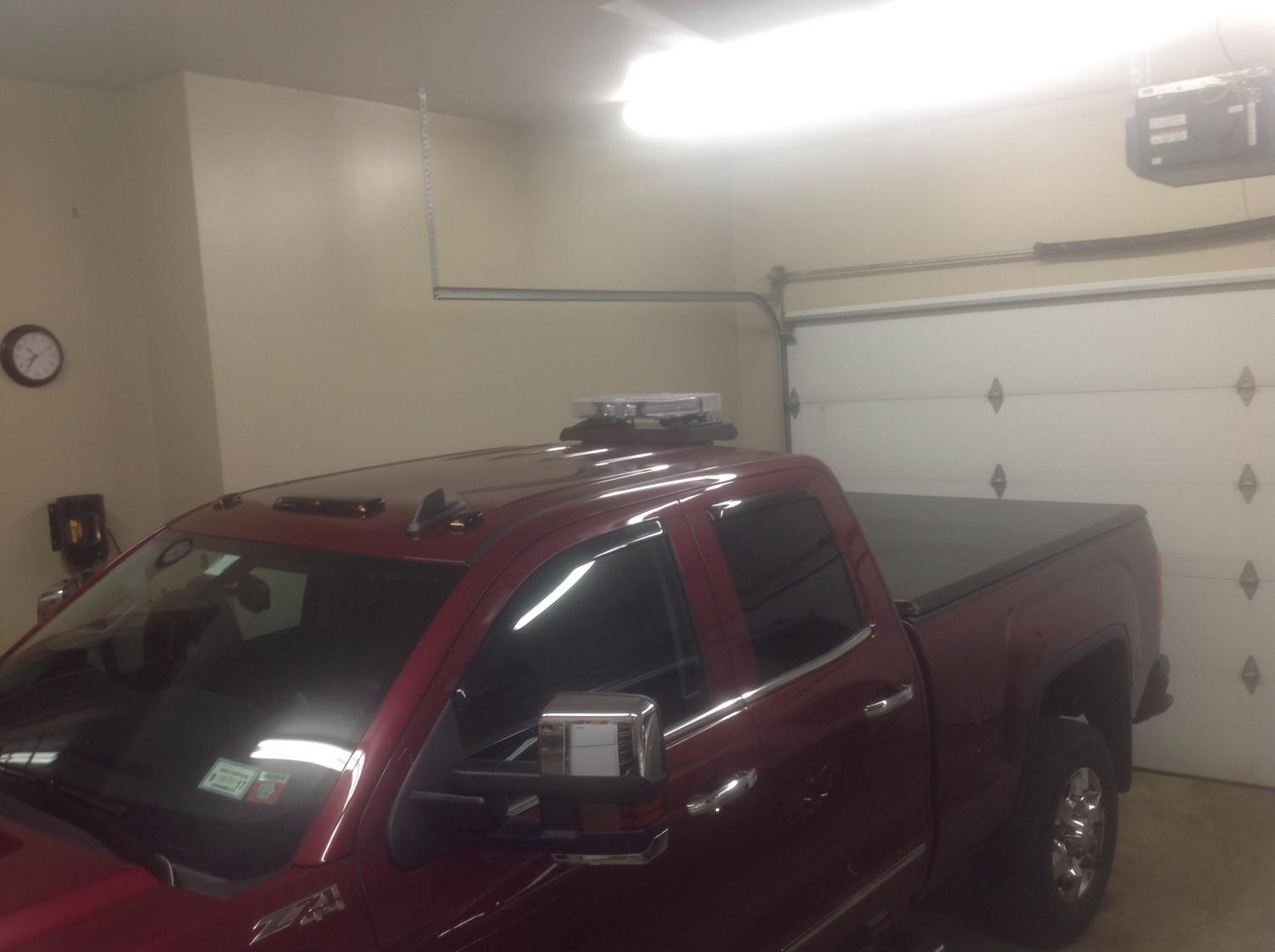

The Acari unit comes in low profile or regular. I prefer the regular mount. T looks better and I don't have garage door height issues.
It's an aluminum finish product, but I opted to sent it to my body shop to have it painted to match.
A nice rig like yours?
It looks like a part of the truck when painted.
If you choose a quality upgradable unit like the Mini Liberty, or any top quality all aluminum commercial quality structure with a permanent mount, it usually comes with its own wiring. My unit came with the corner, police quality LEDs. As I said before, I ordered four extra lights, and there is also a spot for alley lights if you wanted a side light upgrade.
If you have the factory plow package, forget about using the stock wiring under the headliner. Its a waste of time unless you have a single beacon where the light pattern can not be changed.
When you pop off the third brake light, just fish the supplied wire over to the left "C" piller. Pull back the door seal, and pull it through. Run it under the left side, either under the carpet, or up the channel under the door sills. Very easy.
Buy a simple three toggle switch box which are usually under $10.00. Wiring is easy, and the whole project takes just a couple hours from start to finish.
