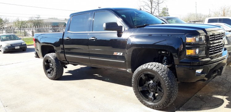

I vote 4.5 inch.
I have the 4.5 in my truck and love it. Lots high. I am running 35x12.5x20s with no rubbing or trimming.
Here is a few pics to give you an idea.

Ah finally posted some more pics! Great looking truck!
XRM15.....I'm not into lifts on pickups, but I have to admit that your 4.5" lift looks nice.
It's kind of a happy medium between a standard Leveled truck and a 6" lifted truck, which look Mini Monster Truck-ish to me. Good choice!

Looks awesome!! Thanks for sharing!
Thank you!
Yeah I like to use my bed for hauling quads and sleds, so I hate a high truck as well. This lift is perfect especially with the 35's. Perfect proportion!
You also get 2" from the larger tires, so i may just go 4.5. Maybe its the angle of most pictures ive seen of the zone 4.5, but yours looks perfect! Some look like theyre not lifted but it may just be the angle.
I'm 6'2 and when I get in it, i have to do a little jump up into my truck. It def is taller than I thought it was going to be. But I couldn't be happier- I wouldn't change anything if I had to do it again.
And you saying it may be the angle. Those are all true pictures. Me just standing and taking the picture. No getting down on one knee and shooting up like a lot of people try and do to make their trucks look higher haha
