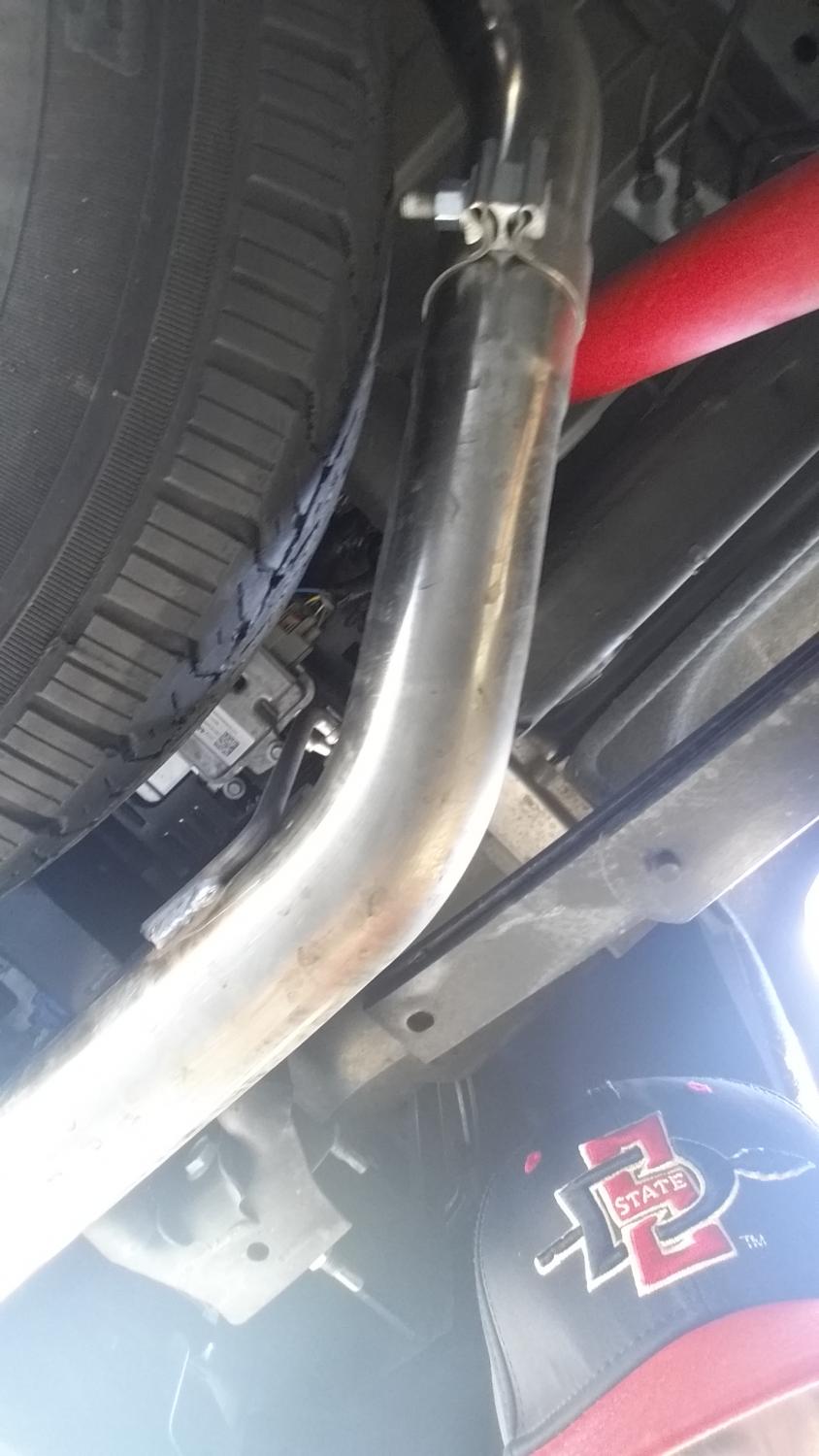

curious about fitment. i've done cat back kits in the past, not a magnaflow, but regardless the kit usually needed the piping bent a tad to look and fit properly. was this pretty spot on? and does it interfere with the spare tire at all as far as rubbing or just in the way? i'm curious because this exhaust gets pretty high reviews and i'm pretty sure once you answer these questions i'm gonna pull the trigger and do the install on my own as well. Thanks in advance.
Sorry it took so long but I finally picked up a spare. I'd say there is a good inch and a half clearance, maybe more. I also wanted to add that there is definitely V4 drone. It took me awhile to notice it more on the freeway. I had my V4 set at only 70+ so it wasnt really an issue but I set it at 60+ to see if I could gain some mpg and now it's much more noticeable. Just FYI...
