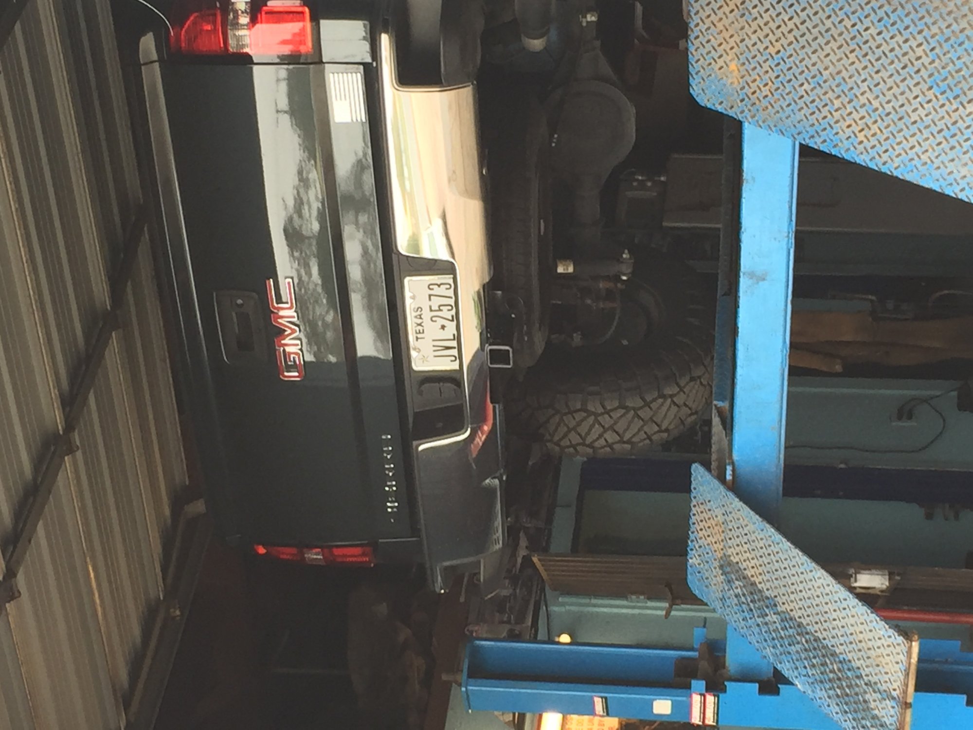

I recently swapped my stock muffler (flapper included) with a magnaflow muffler I purchased at pep Boys for under $90... I’m literally at the muffler shop reinstalling my factory one back on... don’t get me wrong the magnaflow sounded great until it went into V4 mode... I could not take it anymore that helicopter sound was so unsatisfying... so I’ll wait till I can get the gm performance borla cat back..

Ok what a difference ... no chopper sound anymore , I left the resonator off so with that and my airaid MIT with a K&n drop in filter is good enough for me.. still has that rumble at WOT but no V4 chopper drone.. it’s all a matter of what your willing to live with ...gm performance borla (dealer item) includes the flapper on its muffler , so it’s there for a reason... but pricy$$$
