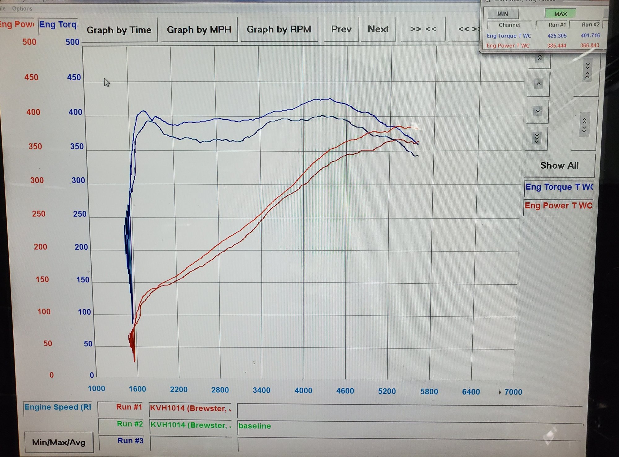

I had my 2018 6.2 Sierra 4x4 dyno and tuned by Pat G Tuning this past weekend. Couldn't get much of a base since already had AFE Power CAI and Borla ATAK. Really happy with his tune! 385rwhp/425rwtq
