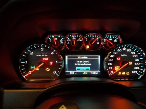

My 2014 never did this either but I noticed it with my 2016, I will get a screen shot when I get off of work.
I have yet to see a message about driver #1 or #2. I also am not sure yet what I am doing differently or if it is something else. But, I remember when I first got the truck and had it all dialed in. pressing the button (without holding) for the #1 position set everything back into place. Now, I have to hold it to complete the change as others have mentioned.
This is on my 2016.
The DIC only gives the driver number message if the fob used is not the same one as was last used. The seat goes to the position associated with the fob when the key is inserted.

Correct, for a while I was getting that message and now no longer see it until driver 2 uses the truck. Here is a pic finally.
