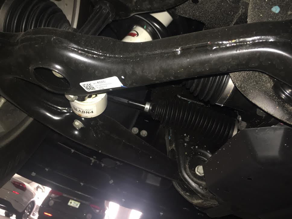

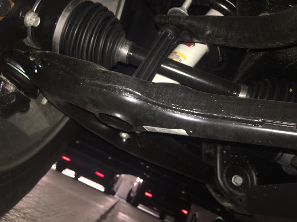

Travis1024 Posted July 25, 2016 Posted July 25, 2016 Sup guys! Looking for some help here, as I am in the process of ordering my leveling kit from RC. I emailed them to verify which part number would fit my truck. Their questions were - - Aluminum or Steel? (i know they are steel based on black color and magnetic positivity) - Stamped or Cast steel? question is how can I tell whether my LCA's are Stamped or Cast? I have a few decent pictures of them if someone can verify which one they are. Just want to avoid getting the wrong kit and having to send it back and all that mess. pics below -
Silvern Sentry Posted July 25, 2016 Posted July 25, 2016 1) Aluminum are not painted 2) Magnet will not stick 3) Build sheet will say premium suspension package (Not to be confused with z71 or offroad suspension package those are steel) Those look like stamped steel to me. Cast would not have welds.
Travis1024 Posted July 25, 2016 Author Posted July 25, 2016 1) Aluminum are not painted 2) Magnet will not stick 3) Build sheet will say premium suspension package (Not to be confused with z71 or offroad suspension package those are steel) Sorry, I should have specified my truck a little more. it is the 2016 1500 w/ the z71 offroad package. I know they are steel, but according to RC, the correct part number varies based on whether they are stamped steel or cast steel.....
Silvern Sentry Posted July 25, 2016 Posted July 25, 2016 I could tell because of the Ranchero shocks I have never heard them ask about stamped vs. cast though. Only Steel vs. Aluminum. Regardless anything that is cast should not have welds on it and looks like those do to me.
Thomcat Posted July 25, 2016 Posted July 25, 2016 I could tell because of the Ranchero shocks I have never heard them ask about stamped vs. cast though. Only Steel vs. Aluminum. Regardless anything that is cast should not have welds on it and looks like those do to me. X2..................looks like stamped flat stock with welds.

Waaazooo Posted July 26, 2016 Posted July 26, 2016 1) Aluminum are not painted 2) Magnet will not stick 3) Build sheet will say premium suspension package (Not to be confused with z71 or offroad suspension package those are steel) Those look like stamped steel to me. Cast would not have welds. Do you know the rpo for that? I have z71 so I'm assuming I have cast steel or are these stamped? Sent from my iPhone using Tapatalk
newdude Posted July 26, 2016 Posted July 26, 2016 Do you know the rpo for that? I have z71 so I'm assuming I have cast steel or are these stamped? Sent from my iPhone using Tapatalk Those are the forged lowers and from what I can see, the forged upper as well.
Travis1024 Posted July 26, 2016 Author Posted July 26, 2016 Those are the forged lowers and from what I can see, the forged upper as well. How odd. I never understood why they put different parts in the exact same vehicles... I've had 2 Jeep Cherokees in the past, both same year, same trim, but different transfer cases......strange!
