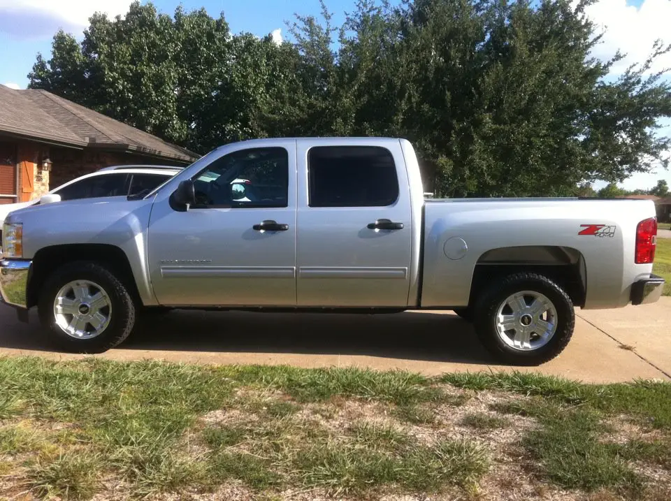

And here she is...a 2012 Silverado 1500 Z71 Crew Cab LT. It's the first truck, I ever bought, that was brand new. I have added an above the rails low profile tool box, dark tint, and a spray in bed liner. Other than that, all stock for the most part...
