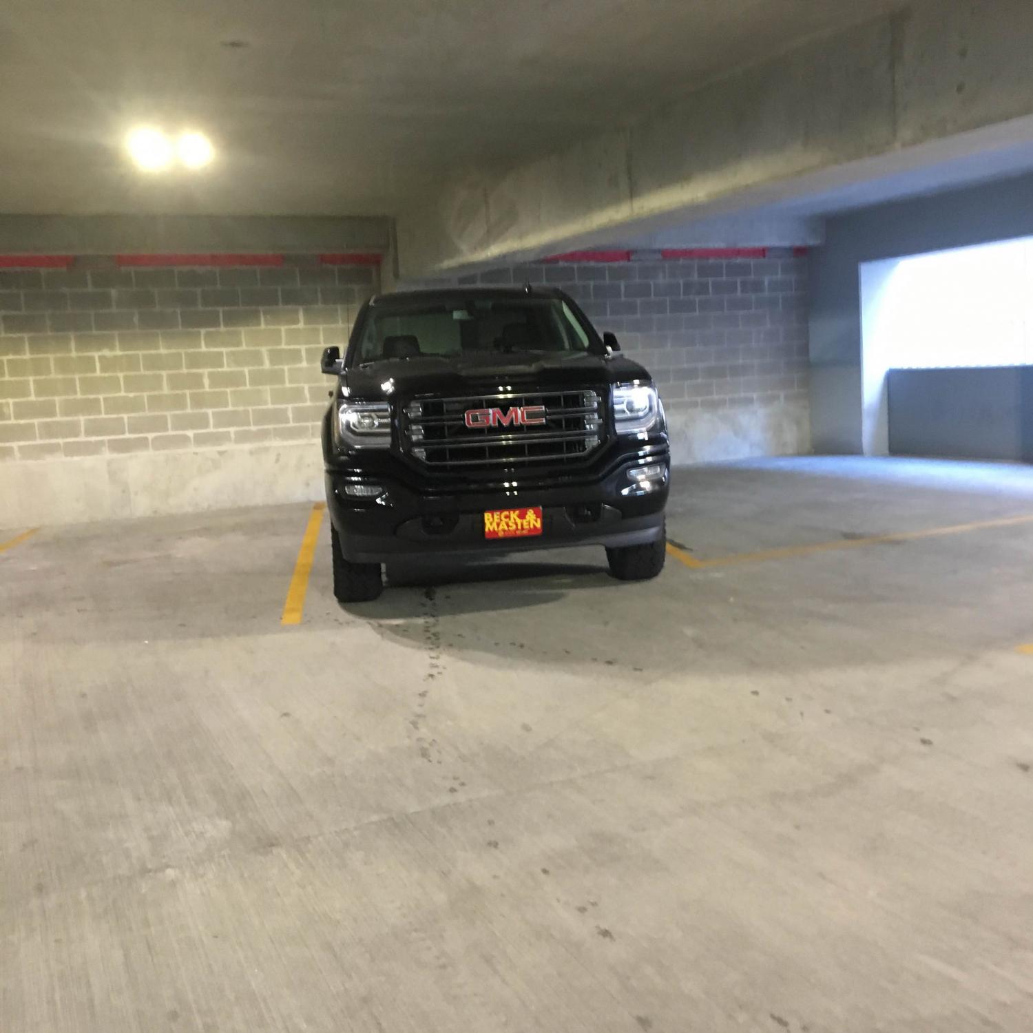

I finished the lift this weekend. I will note that several parts were a pain in the a$$.
1. lowering the front diff. and getting the 1" spacers in, was a pain!
2. Getting the Upper ball joints to release from the Spindle was a huge pain in the a$$ ( Hammered the heck out of the knuckle and also broke a pickle fork on it.
Those were the only to set backs that took longer than expected.
Taking it to get aligned today after work! here are some after pics.
I will put more pictures up when i get home tonight. I have the measurement differences as well.

Looks good. I agree on ball join to spindle. In my 3 inch install we had a 5 lb hammer hitting the spindle and it finally gave but it was a lot of heavy hits. I think the first "break" is the hardest. Of any car or truck I ever had to break them loose the factory break was the toughest. How was the cutting of the cross member? Did you weld metal in the hole to strengthen it and keep dirt out. What's weird is with my 3 inch I feel my stock rims and tires look tiny....on your 4 inch yours don't look so bad. Are they stock tire size?

Cutting the cross member was easy with a cutoff wheel. when i bolted it back up it didn't look like it was necessary though. You don't really have to cut that much off it. I didn't weld the hole back, just sanded and painted.
they are stock tires that came on the All-Terrain.
265/65r18 (31.6"x10.4"x18") Goodyear Durotracs
