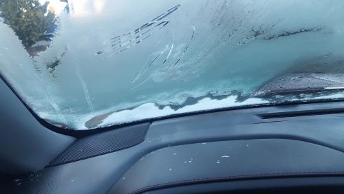

The dealer thinks that my truck has the same issue with the antenna, only they couldn't do the repair when I stopped by due to their water lines being frozen so there was no way to test the repair. I will have to stop by as I am getting tired of having to scrape the inside of the windshield...

So now I'm waiting for it to act up again so I can video the dash when it lights up like a Christmas tree...And I see water dripping from the ceiling. I've only got 10,000 miles on the truck and I'm getting frustrated with these little issues. I don't have time to keep running it to the dealership once a month.
