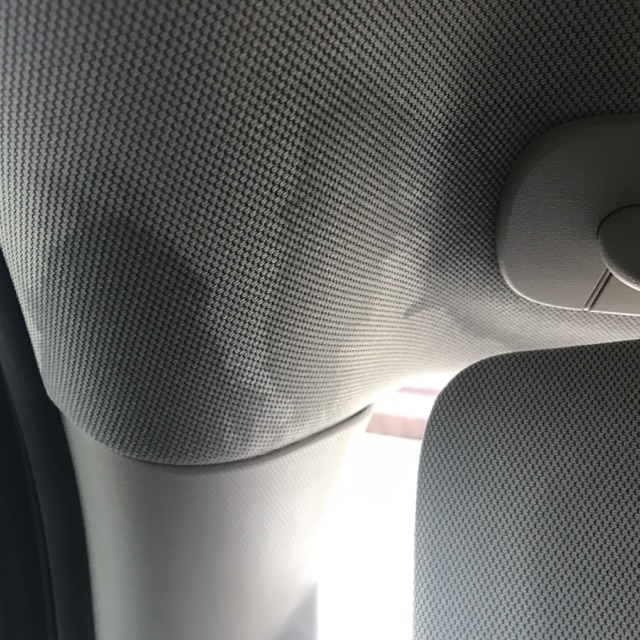

Just bought truck new in September, I have been through car washes, rainy weather and never had a leak. The first wet snow we got about a two weeks ago and got in truck and saw this, it was leaking so bad leaking it was running all the way down pillar and onto emergency break pedal! I made an appointment at dealer, they said it was the satellite antenna leaking, and that a lot of new trucks are doing it. Had to order a new antenna for it as its all one piece, had it installed yesterday, will see if it fixed the problem! I also told them i wanted i new head liner and they said was on back order at GM since they are replacing so many of them! Just thought i would give a heads up (literally) to watch for this problem!
