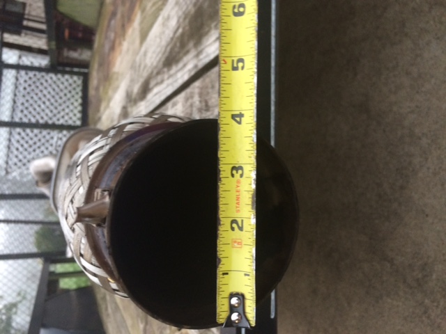

Not very easily the muffler shop would have to make an adaptor the 6.2 is a 3.5" pipe at the third cat connection and I think the 5.3 is a 3"
that is a pic of my 2016 6.2 exhaust note that the pipe is flared out slightly to fit over the end of the third cat it is a 3.5" tube.
What he said. The connection piece has to be expanded on the Y or shrunk on the catback.
