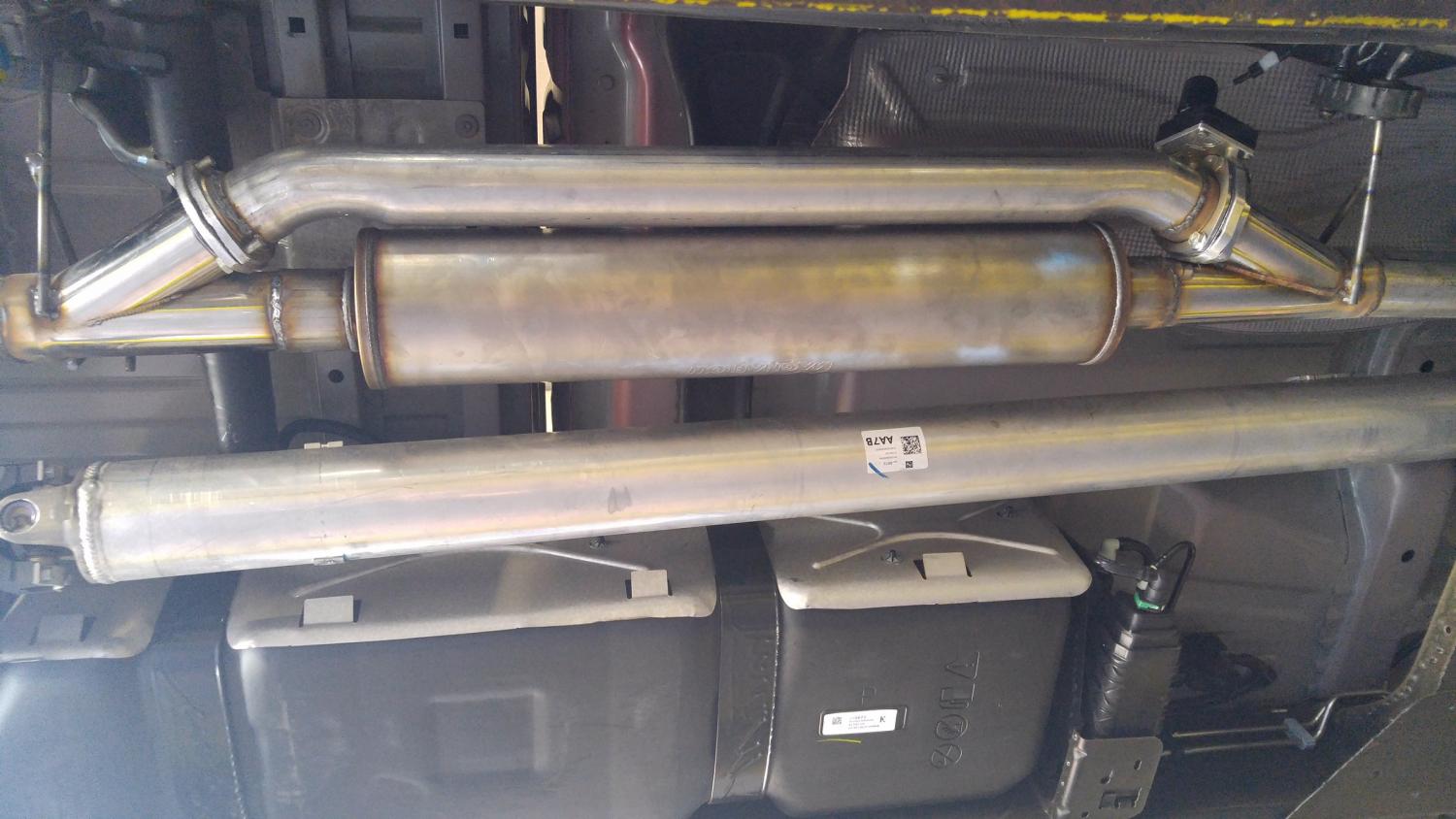

Hey all -
I don't spend a lot of time on web forums posting but I spend a ton of time researching answers to questions because it's the only place to get real answers. So, whenever I have something that I think would help others, I feel compelled to return the favor. I thought I'd share my exhaust in case anybody was interested (truck is a 2017 crew cab) which sort of mimics the function of the NPP mufflers that came on C6 Corvette Z06's and the muffler bypass. Components were pretty simple and exhaust dumps over the rear axle with a 4" tip:
- Removed 3rd cat and everything behind it
- Magnaflow 12641
- DMH 3" electric butterfly valve
- SS 3" cutouts
The 12641 is 30" long (body), 6" round, 3" I/O. I chose it because...
a) I wanted the muffler to be noticeably quieter when the bypass was closed and this is Magnaflow's longest 3" I/O muffler
b) I needed a round muffler to make room laterally for the bypass pipe
c) Nobody else makes one this long, in this outside diameter, 3" I/O, etc
So, if the valve is shut - it's like most 3" catback exhausts (minus the 3rd cat). But if the valve is open, it's essentially straight piped... although a good portion of the exhaust gas still goes through the muffler because either route is straight through before they mate back together. As far as sound... amazing. Better than I expected. I've never been so happy with an exhaust project.
When the valve is shut, the muffler is quiet, as desired, and I can tell that it hasn't broken in yet... mild, deep, mellow tone. When the valve is open, it's louder (of course) and the sound and the tone are awesome. I'd assume it's a touch milder than a "true" straight pipe... the only way I can describe it is an "old school" sound. What surprised me most is that I can't hardly hear it inside the cab - valve open - cruising down the road with the windows up. There is no drone, it doesn't invade the cabin, etc.
Pictures below. Hope this helps anybody interested. Here is a video:

It's a 5.3... it wasn't hard. Just call DMH and find a good exhaust shop. The hardest part was wiring the switch.
Very nice exhaust setup. Also, if you don't want to go the parallel pipe route, you can always just install the cutout in front of a stock muffler... super quiet to super loud! :thumbs:

To the OP, nice job, sounds good. A bit loud for me with cutout open (used them many times for street track cars), but I like the tone with it shut, nice and mellow.

Damn that sounds good. I don't think I'd do it to this truck but it makes me miss my old 02 Silverado, I just cut off the muffler and that thing sounded killer

I use to have my exhaust shop do something similar. Option one was run a y pipe muffler on one side and a straight pipe one all the way back with turn downs just before the back bumper. The strait side I weld a header flange close it with wing nuts. Or run the straight out in front of the rear tire. On a trip I'd run quiet, local I'd run loud. I don't trust electric cut outs.
