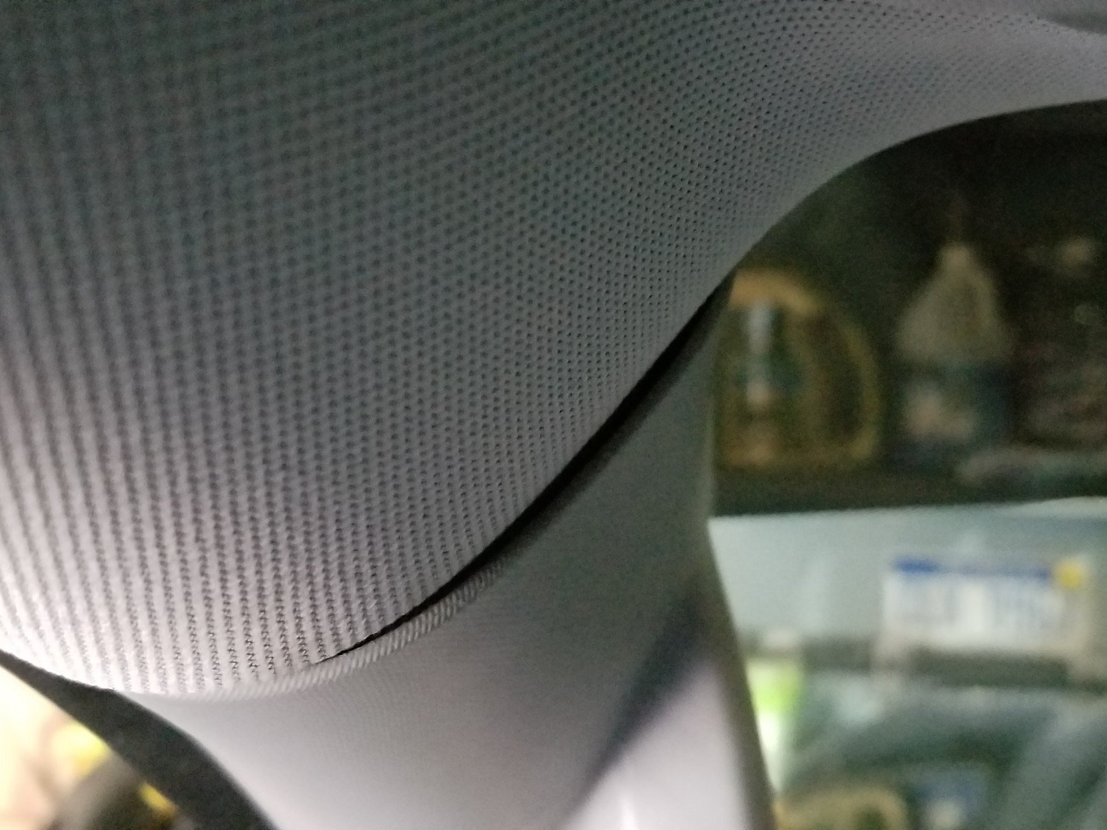

I also noticed that the fit wasn't exactly perfect like the old one, there was a "gap" as referenced before, which isn't a gap exactly, it just isn't pressed very tight to the top.  You would probably never notice, but I will know!  I didn't need the handle, but it's all in the name of saving the side of my leather seat from getting all worn, so I'll consciously make sure to keep from sliding my butt over the edge.
Installed mine today, there was a small gap on top portion it was late so I try to adjust and report back. Any tips on eliminating gap would be helpful. As for no tether I believe you wouldn't need it as you bolt this new one in and old one stays in with a clip only and could shoot off from airbag.

After reading about how some people broke the new part or couldn't get it to line up with the headliner exactly I opted to pay the 20 bucks for the dealer to install it to make sure it was done right....or at least that was my hope haha.  I also have the gap near the top.  Like others have said it's not huge and the handle is still fully functional and looks ok, just not as tight as the passenger side near the top.  Has anyone found a way to get it to sit correctly that had this gap issue?

If it was me I'd pop the bolt covers off,  loosen the bolts up a couple of turns, and try a little persuasion. Mine had a gap at the top when I first installed it but I was able to wiggle it around and pull up while tightening the bolts and now there is no gap. I'd try that before wasting half a day at the dealership waiting for them to do the same thing.
Even though these trucks are built by robots they are by no means perfect. The bolt mounting pads on the A-pillar may be just a tad off.
If need be you can enlarge the mounting holes in the driver assist handle to allow it to slide up that extra 1/16" of an inch.
